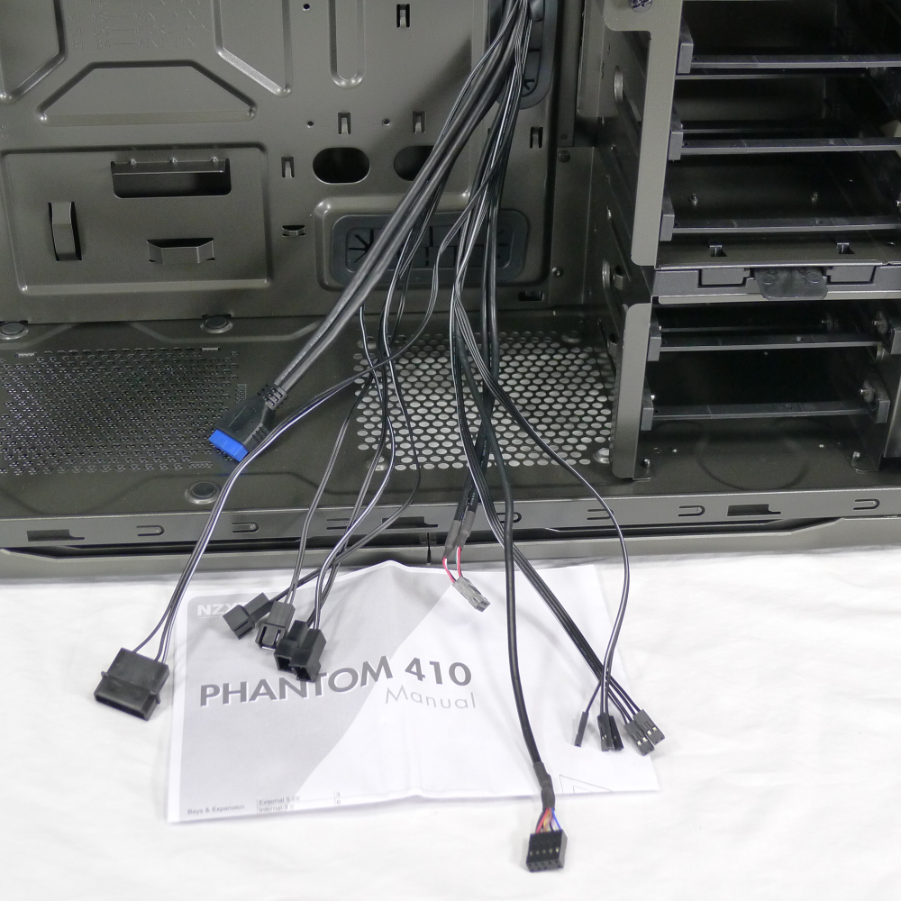

So I got my PC all set up, and going from a cm haf 932 to a NZXT Phantom 410, and the way you connect the case fans seem to be different.. On the HAF 932 you would connect it straight from the fans to the mobo, but on this one there's a fan controller. How would I go about connecting that? The only PSU cables I have btw are the two PCI-E ones for my GPU and a SATA cable.

You can either disconnect all the fans from the controller and plug them into your motherboard or plug a Molex power connector into the fan controller (assuming your PSU has Molex connectors).

Actually, could you take a picture of your fan controller and post it here? I'm not sure if the controller is powered by a motherboard fan header or a Molex connector. Anyways, here's what a Molex connector looks like:
Well I tried looking around for the hub but couldn't find it, not behind the motherboard tray. I'm pretty sure all the wires for the fans lead up to underneath the fan controller that was in my earlier pic.

After looking at a review, I know what to do:
1, Connect the case fans to the fan sockets:
2, Connect a Molex plug rom your PSU to the Molex socket.
If you don't know where your Molex cables are, post a picture of all the cables that come with your PSU and I'll point out where they are.
The case came with all the case fans wired, the only loose wire left in my PC is that fan controller connector (in the link in my original post, that also came pre-wired and I have no clue where it leads to due to all the pre-wired/tied cables.) This connects to the molex.

Not the right one. It is a 6 pin molex cable, but I already tried putting that one in my PSU, and it doesn't go in all the way but not only that, it shut off my PC instantly when I tried. Also the fan connector cable won't fit inside the other end either.
Yea I figured that one out when I tried to buy pre-sleeved PSU cables, but found you have to get the cables made for your PSU exactly...
Contact Seasonic and ask if they can send/sell you a molex cable. They may send you to their OEM cable producer meaning your SOL, but they also may send you a free molex cable.
I read online when people tried to ask for something similar they got responses from "We can't help you, contact our OEM cable supplier" to "No problem, we'll send you some extra cables."
