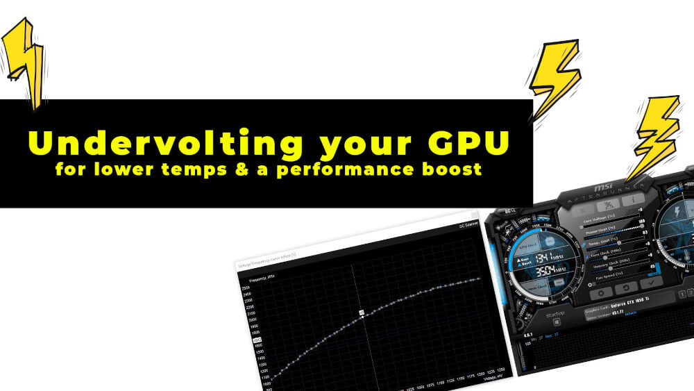

Have you ever heard of gpu undervolting?
I have been doing it on my gtx 1070 ti in my dktop and on my gtx 1060 6gb in my Asus laptop.
On the dktop it has lowered the temp to 58c from 64c .

im currently going through the process of undervolting, so far i dropped around 2c.
