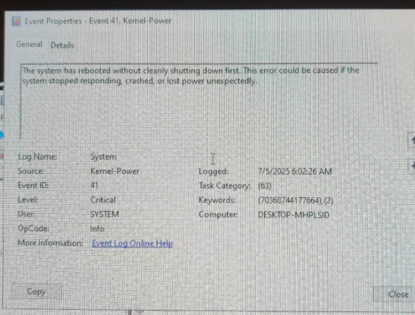

Here is a picture of when i entered and was able to open the event viewer, from the time, this was exactly the time i put the device to sleep before i slept myself.
The Case/CPU/MOBO/RAM/PSU are all new, the pc was working fine past 4 days, but then today this happened.
