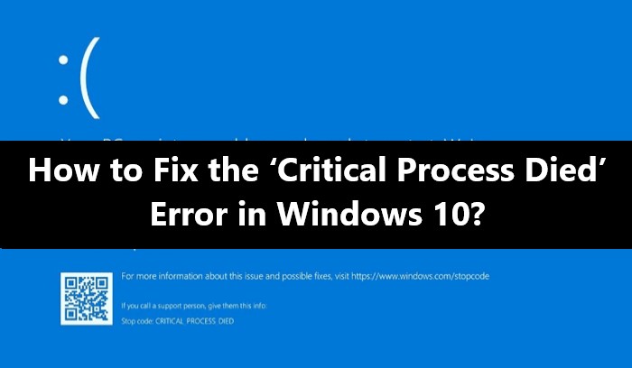

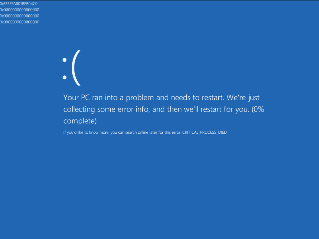

Hi, I ran the dump files through the debugger and got the following information: https://jsfiddle.net/me3tfbq2/show This link is for anyone wanting to help. You do not have to view it. It is safe to "run the fiddle" as the page asks.
File information:050921-40078-01.dmp (May 9 2021 - 09:11:18)
Bugcheck:CRITICAL_PROCESS_DIED (EF)
Probably caused by:ntkrnlmp.exe (Process: svchost.exe)
Uptime:0 Day(s), 0 Hour(s), 03 Min(s), and 42 Sec(s)
File information:050921-37343-01.dmp (May 9 2021 - 08:55:02)
Uptime:0 Day(s), 0 Hour(s), 03 Min(s), and 08 Sec(s)
File information:050921-33421-01.dmp (May 9 2021 - 09:05:28)
Uptime:0 Day(s), 0 Hour(s), 03 Min(s), and 21 Sec(s)
File information:050921-29125-01.dmp (May 8 2021 - 21:43:40)
Uptime:0 Day(s), 0 Hour(s), 00 Min(s), and 47 Sec(s)
File information:050921-24640-01.dmp (May 8 2021 - 21:46:26)
Probably caused by:ntkrnlmp.exe (Process: services.exe)
Uptime:0 Day(s), 0 Hour(s), 02 Min(s), and 12 Sec(s)
This information can be used by others to help you. Someone else will post with more information. Please wait for additional answers. Good luck.

https://www.partitionwizard.com/partitionmagic/critical-process-died.html
