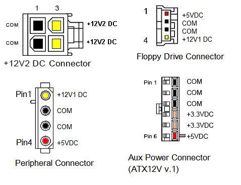

In short: Hell no. They are keyed differently and you can really mess up your system that way. See how the yellow powered wires and black ground wires are reversed top-to-bottom? Read this article for more details:
http://www.overclock.net/a/gpu-and-cpu-power-connections
You shouldn't even be able to plug one into the other, which is why they have the squared vs. rounded shapes of the plugs - but you can probably do it if you force it. But don't do that.
White is atx connector from old psu and it is compatible with MB, I thought if I have 12v and ground on wires on gpu cable, if i connect them in right way thay can be used as extra 4pin atx for 8350 that i itend to overclock.
This is one of original cables of seasonic that can be connected on psu (labeled pcie/cpu) and has pcie connector (I lost this cable).
This cable goes to 8 pin that i have connected, i just need 4pin atx so i used one of extra pcie cables that I have and rearanged wires, should it work with that logic? Also I red that same link couple days ago.
Edit: Isnt it connected right, 12v and ground as it should?

I dont use fabric pcie for cpu,I use one end of it and second I rearange cables so they should be fine for cpu(use some of cables and put them in whit jack in pictures above so can fit nice in MB)?
If you have the 8-pin connected already, there is no need for the additional 4-pin. The motherboard only has both plugs in case your PSU only has one or the other.
The 8-pin cable by itself supplies up to 235W, and there is no way your CPU is going to use that much even with an extreme overclock.

There would be no harm in plugging in both the white 4-pin ATX and the 8-pin ATX at once, just don't try to use a PCIe connector as a CPU connector. Originally it sounded like the thread was about trying to use a PCIe 6+2 to plug into the motherboard, but if that's not what you're doing, then by all means connect both CPU plugs.
I do understand that now, just wondering if this cable would work? I got out wires from 6+2prcie as u see and put them in "correct" way in old whit atx jack(plastic, sorry on bad english).I didnt intend to use these 6+2 connectors just white ATX as extra power supply cable. I ll try without it but in case of unstable voltage, what u think, should this work?
Oh, I see - you rewired it into an old ATX plug. Maybe that'd work, but I would only try it if you had no other options and were REALLY confident you knew what you're doing. Much safer to try and get a replacement cable.
