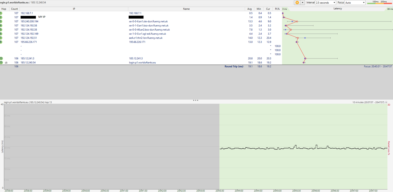

Ping plotter test to check for packet loss

Everything you have posted again shows you have no network issues at all. Everything is running very well and a lot of it like the wifi setting don't matter since you are using ethernet.
Just because the game says you have a network issue does not make it true. It is much more likely the game has some issue with your machine. Since other games do not have issues this means it is no something simple like hardware issues.
From in the middle of this thread you said if you change the FPS setting in the game it stops doing this. This makes it more likely it is some issue with the game and its interface with the video drivers. Since different games have many different video settings it might be just one setting causing the issue.

What caught my attention is that you "MY IP REMOVED" the IP addresses shown for Hop 2 in Traceroute (Post #20).
However, those HOP 2 addresses are shown in PingPlotter Free as HOP 3.
As I understand the tracert(s) in Post # 20 Hop 1 (your router) was originally 192.168.7.1.
Then you added the Asus router.
Per Ping Plotter Free the Asus Router is now your main router (192.168. 50.1) and that is the router that should be providing DHCP IP addresses to network devices. And/or managing any Static IP addresses.
[Note: 192.168.50.1 being a default IP for the Asus router.]

So my question is what is that 192.168.7.1 device now being shown as Hop 2? Post #14 shows the device as originally being the Default Gateway. My thought is some modem/router. ISP provided? Make and model? Who has admin rights to that device?
Have all network devices been reconfigured to use the Asus Router (192.168.50.1) as the Default Gateway? Verify that all network devices are correctly configured and using DHCP IP addresses within the the DHCP IP address range allowed to the Asus router. Check subnet masks as well. Ensure that any static IPs are correctly configured and reserved.
The router should provide some listing showing connected network devices, IP addresses, and MAC's. The "arp -a" command via the Command Prompt may help reconcile everything.
If Device 192.168.7.1 is indeed a modem/router has its' DHCP IP functions been disabled?
Also FYI:
Public vs Private IP
I think you are working the tracert backwards. The 192.168.7.1 is the private side of the router, then the first hop is the public IPV4 (wan side of router) address that the op removed for privacy and replaced with "My IP Removed" and then the corresponding hops are the additional router IP hops leading to the dns assigned ip for world of tanks.

looking like my network is in top shape so this must be driver or windows related. 3 machines same issue so doesn't look like I'll find a fix. End of the day least my pings not over 100 so I should think myself lucky. Thanks anyways
Your problem is things like firewalls and other software might delay or drop the data they won't magically make it 1ms. That has to be wrong data since it is not possible.
Your other testing data shows the latency to the server locations to be about 20-30ms. So the first problem is why is game telling you it is 1ms. It can't actually be 1ms, it would mean they had a magic way to send data faster than the speed of light, so the game has a bug of some kind.
It is hard to say if this is a separate issue or it is the actual cause of your performance issues in the game. Problem is no game company provides any public access to their software so it is impossible to tell what any messages really mean.
Maybe contact the game company but don't complain about the performance, just ask them how it can possibly be 1ms since that is faster than the speed of light.
