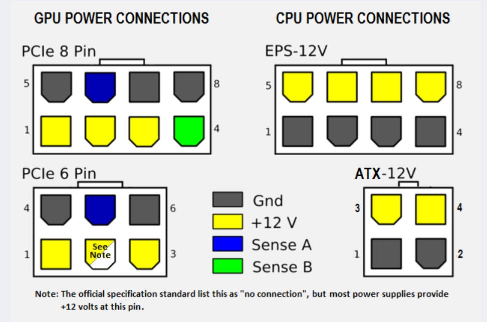

I have a corsair cs750m 80plus gold fully modular power supply. Now, my question is with the 1070 it says 6 pin and 8 pin.
My psu looks like this: http://imgur.com/a/GMc1A
I only have the 6+2 pcie spot & 4+4 cpu spot open.
I bought this from CyberPower and they said they don't "officially" support third party stuff for liability reasons. They said that if I use the 6+2 as an 8 pin into the gpu it should work. I just want to make sure that using the 8 pin alone can power the 1070.
If not, is there any better way to do this? Like can I use the 4+4 cpu somehow?

You should use all your power connection ports on your GPU (On any computer component for that matter). Less chance of it overheating or blowing PCB trace (if a component will draw 100 amps, its better to have 2 cables sending 50 amps each versus 1 handling the full load of 100 amps). If a connector will fit into your socket on your GPU it *should* power it appropriately. They are all "keyed" so you don't put them in wrong.
I see what you're saying, it's better two at 50% than one at 100%. Could anyone shed some light on how I could go about doing this? I need a 6 & 8 pin, only have the 6+2 and 4+4 cpu spots on my psu.

You cannot use the 4+4pin CPU (ATX12V/EPS) cable in the 8-pin socket of your GPU as 1) they won't fit, and 2) they are wired differently:

Add to the fact that the CS750M only comes with one 4+4pin CPU cable that is attached to the PSU frame, so, since you'll be plugging that into your motherboard, there's no other 4+4pin cable left.
So, for your GPU power, you will only use one PCIE cable which already have two 6+2pin connectors as mentioned/shown above.
At the GPU-side, you plug the first 6+2pin into the GPU's 8-pin socket, then, you plug the second 6-pin (excluding the 2pin) into the GPU's 6-pin socket (leaving the 2-pin unattached). Like this:
At the PSU-side, you can plug this PCIE cable in either of the two 8-pin socket you shown in your photo link. Both sockets are interchangeable (can be used for PCIE or CPU cable) as far as this PSU is concerned.
