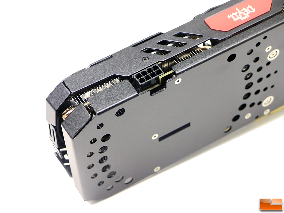

Have you plugged in additional power cord for GPU ? Make sure it's properly plugged in.

Yea its plugged, yellow diod is shining... In dota its hapened after 40 min, i restart pc and came back to the gane and its work... next game it hapened after 5 min... In dead by daylight it hapened after 5-10 min too... Iam playing fifa for 2 hours and not problem.. its weird..
Ok so I looked into manuals and there's nothing mentioned about that LED.. weird.

LED is white all the time, when i turn off PC its still white. And they are spinning..
