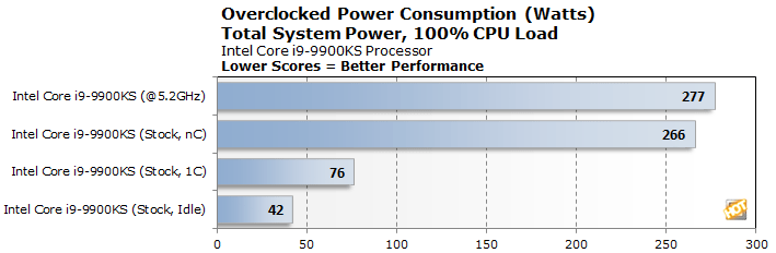

The CPU will just throttle once it reaches temp limit which is 95c. I hit +83c in prime95 with a 4.4GHz overclock. This is using a full custom loop water cooling setup and a cold day. 103 watts is very unlikely as well. I can Cinebench at 60-65c. Once you run aidia64 or prime95 that will hit 120watts. This is not bad really watts wise, (9900ks @ 5.2GHz is very high watts wise, think near 300 watts https://images.hothardware.com/contentimages/article/2914/content/power-9900ks-2.png ) it's just the cpu cores on ther die are 7nm and happen to be offset from the centre. Most of the cooling is at the centre of the IHS with my water block.
