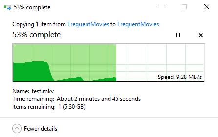

When transferring video files(~10GB) from HDD to SDD, my transfer speeds are hovering around 40MBps.
When copying the file from the SSD onto itself, I am still averaging around 40MB/s but it looks like a saw tooth:
Would appreciate any insights.

"from HDD to SDD "
Speed is dictated by the slowest device in the chain.
Here, the HDD. Doesn't matter how fast the SSD can write. The HDD can only feed at its own rate.
"copying the file from the SSD onto itself, "
And that will be slow as well. You're asking the drive to read and write at the same time.
That sawtooth is alternating between read and write.
The only time you see at or near the advertised speeds is doing a benchmark, or transferring between two similar drives.

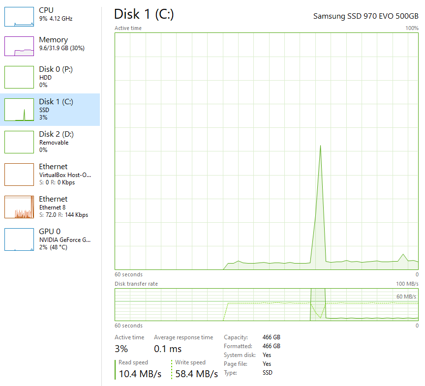

  6. I have transferred files the same files from the HDD to a network drive and it averaged above 100MB/s, so the bottleneck seems to be the SSD
  7. Not sure if this is a new issue, this is a new drive. I used clonezilla to copy a disk image for a different SSD
  8. Benchmarks for the drives seem normal, see below
Those Sequential benchmark numbers in Magician are right on track with published numbers from Samsung.
