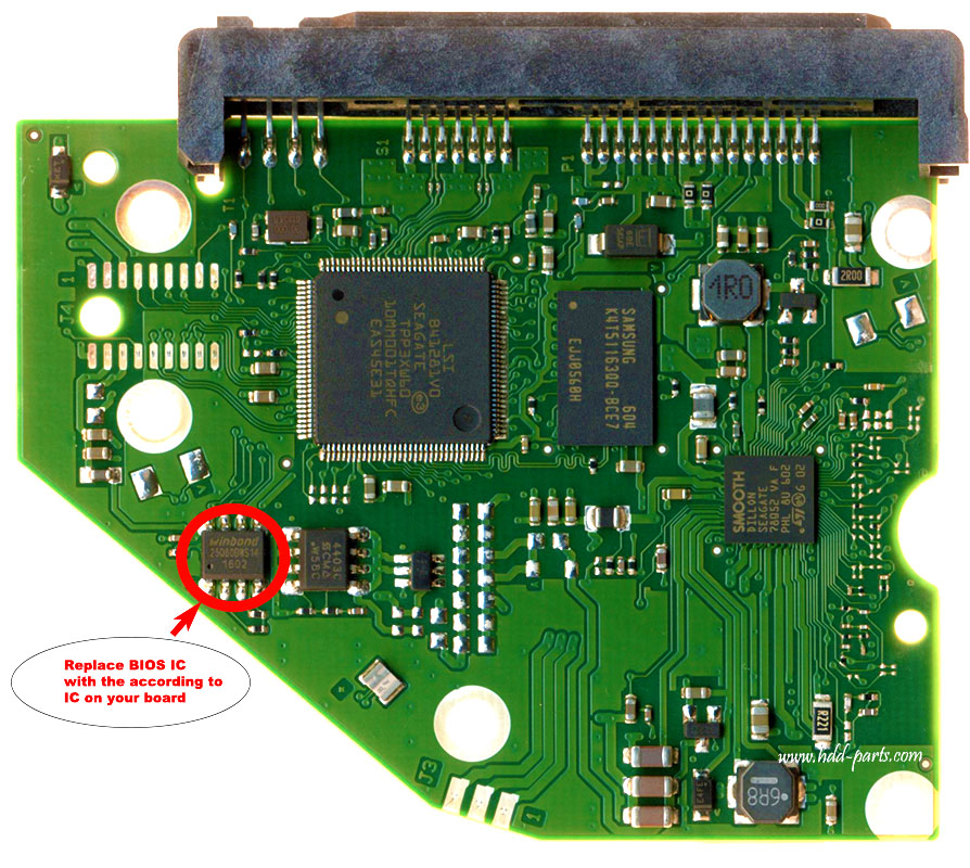

I think you need to transfer a small servo calibration chip over from the failed board to the donor board, otherwise you won't be able to read back data. It's a good thing you have all the data backed up isn't it? You do have a backup don't you?

Yes, this is right. There is zero chance of finding a "a doner Hard Drive with exact FIRMWARE".
"Adaptives" -- why PCB swaps don't work in modern HDDs:
https://www.hddoracle.com/viewtopic.php?p=19090#p19090
There is a possibility that the PCB can be repaired, but we would need to see the other side.
https://s.turbifycdn.com/aah/yhst-14437584971410/918062903-1.gif
