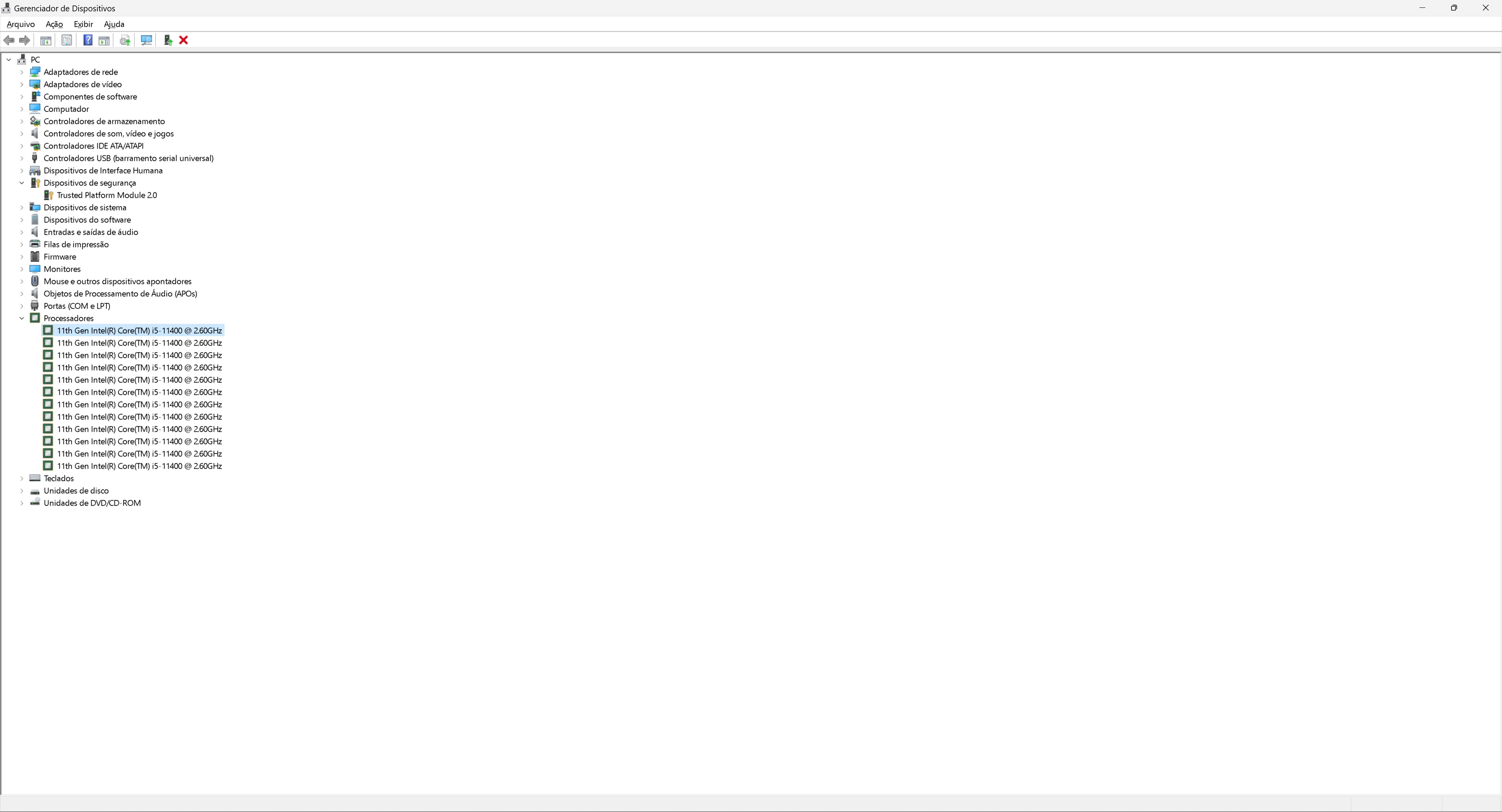

Note: this PC is clean of malwares, too. I asked for help in the MBAM forums and if there was anything there, it's gone now.

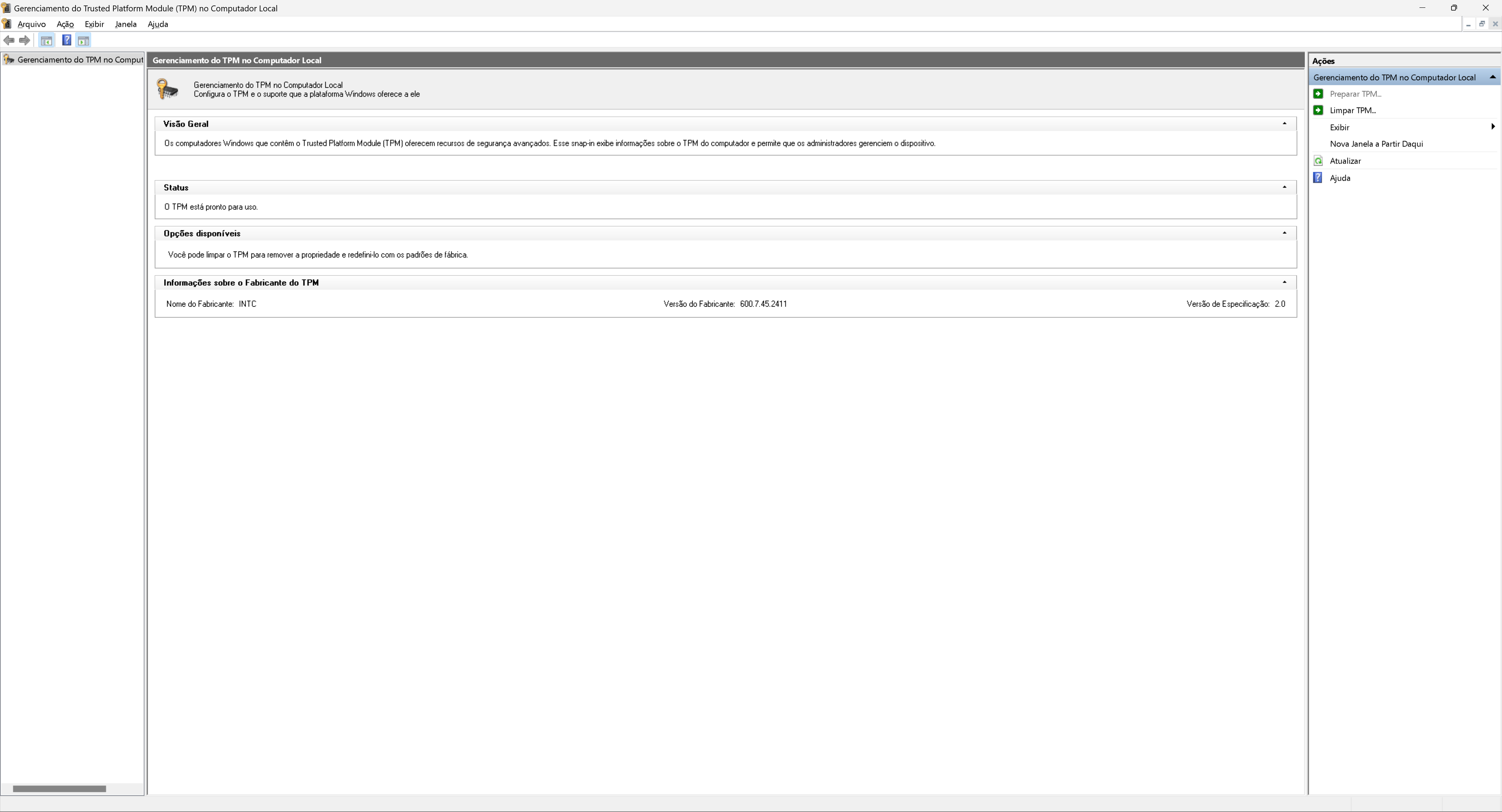

About the BIOS, TPM is enabled there. CPU is the i5 11400.

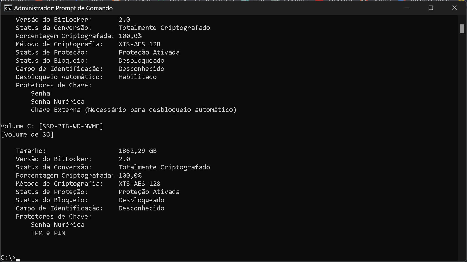

This link shows what CMD says about Bitlocker. Key protectors are TPM and PIN, and numerical password.
Not only TPM is showed there (link here)
I made sure this W11 install didn't use any hack to allow TPM bypassing. The CPU is TPM-ready. PROOF here
