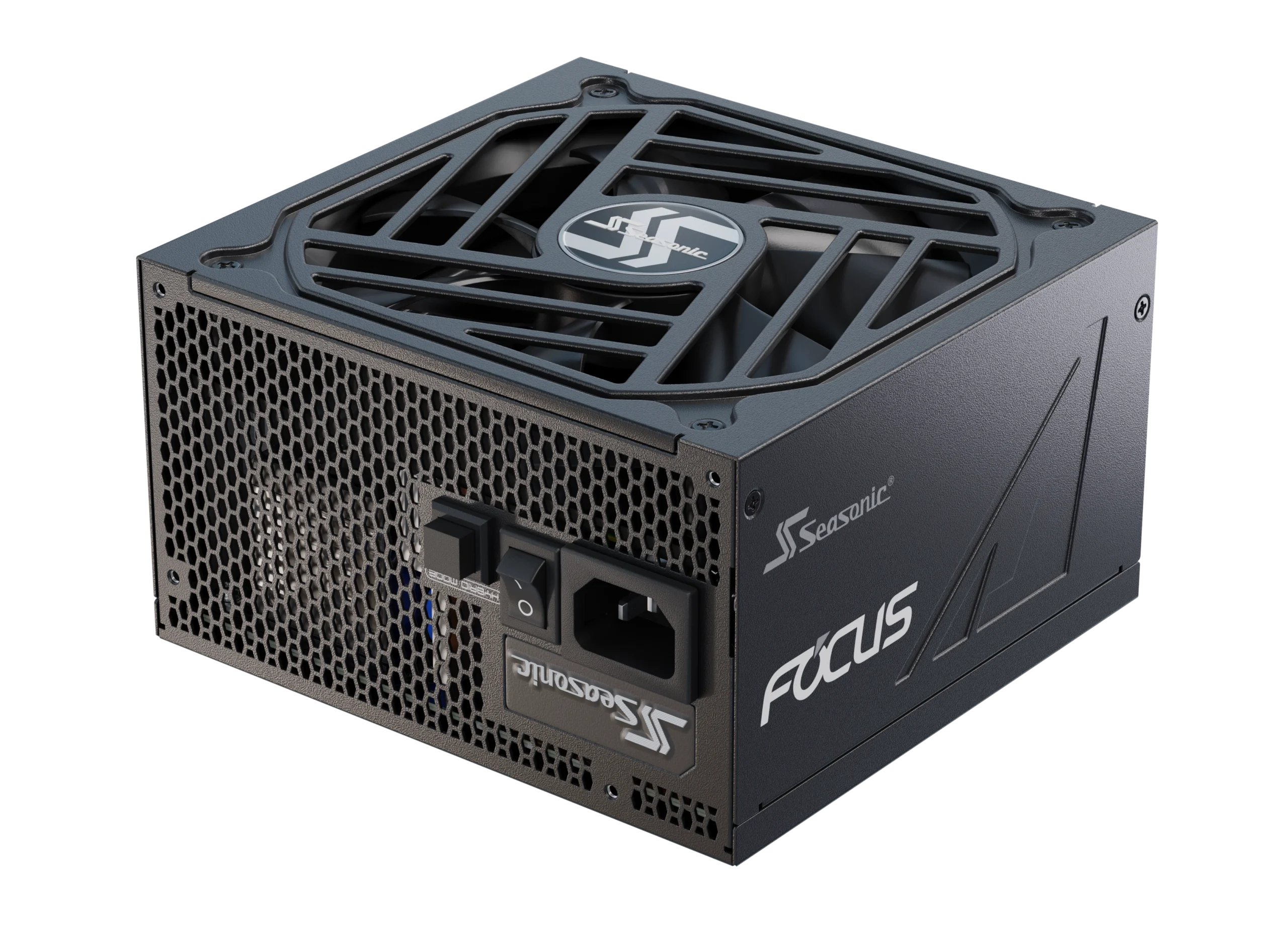

Hi
Anyone knows whats the fan inside SeaSonic Focus GX750 ATX3.0 v3 with part number SSR-850FX3?
140mm 25mm or 30mm?
3 pin DC or 4 pin PWM?
Can replace with Corsair ML140 LED Elite or RS140 or RS140 Max?
Thanks.

It also appears to be a 135mm fan, per the specs listed at Seasonic.
Which means it's proprietary. You won't find a decent, reliable replacement without going to what was already in there, and the general public probably doesn't have access to procurement of that specific fan without going through Seasonic. And probably not even then. If you can determine the manufacturer of the actual fan, MAYBE, but I doubt it.

It's a Hong Hua HA13525H12F-Z and no, you cannot replace it with a 140mm fan because 140mm does not fit. It's not 3 or 4 pin either. It's 2 pin.
