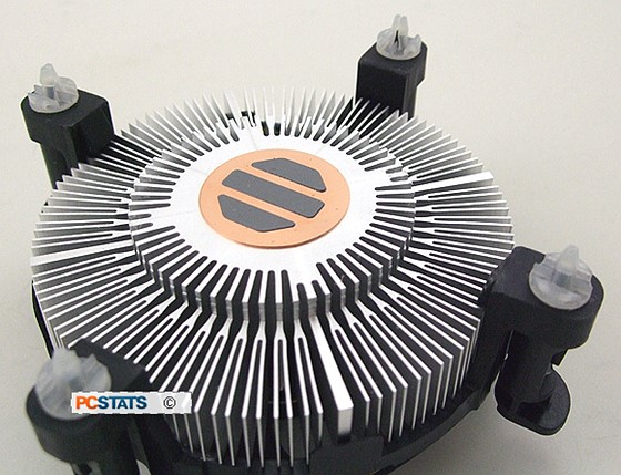

I wonder how the factories have been applying "phase-change" (i.e. low-temperature melting plastic) to heatsinks for 30 years now. Probably either they melted it and rolled a square of liquid on like paint, or it came in huge rolls with backing on only one side and it was pressed on, backing and all. The backing could then be peeled off after it was firmly affixed to the heatsink.
They really ought to make these things so one of the backing plastic sheets almost falls off by itself so you could apply it the same way.
Of course back in the day these were not great performers because of their thickness, as they were really intended to help keep people from chipping the corners of their bare Slot-1 Pentium II or Slot-A Athlon dies, since grabbing the cartridges from one side to plug them in put tremendous loads onto the edge of the heatsink. Even now they work best with either high contact pressure to squeeze out most of the plastic, or else after one exposure to very high heat to do the same (as in run without a fan for awhile)
It was the first practical pre-applied thermal compound, though for IHS they later got good at pre-applying very dry paste with gaps, that was protected by a plastic cup in the packaging instead of a peel-off sheet
