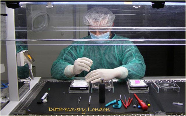

When you have stomach pain, do you grab a knife from the kitchen and slice your belly open and check out the insides?
This is where you check the inside of a hard drive.
This is where you do not.
At least you made the decision to pay for recovery an easy one; if recovery is not now impossible, it's harder than it previously was.
