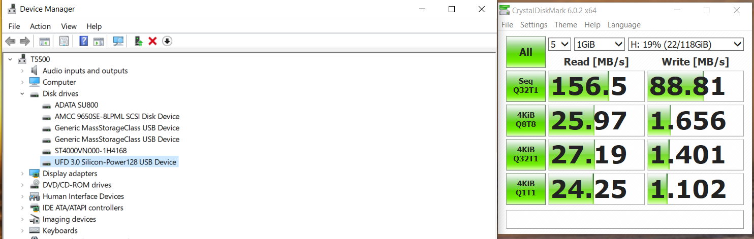

My motherboard is pre-UEFI (X58) and the add-on controller works just fine:
https://www.amazon.com/gp/product/B015JYYZNY/
sandisk-png.113993
lexar-png.113992
usb3_128g-png.113982
