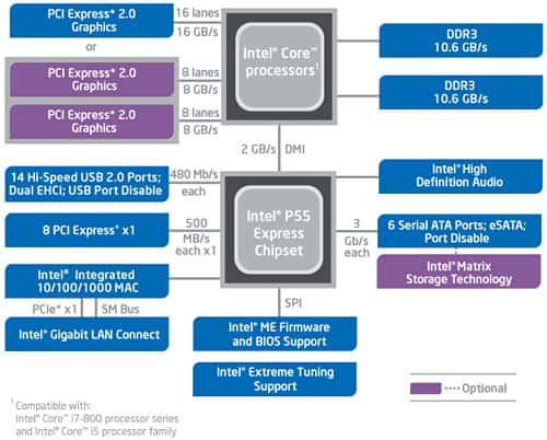

I would argue this is largely a myth. For one, everything today is more or less connected over PCIe, which devices must implement a set of standard commands. Those commands would include being able to ping and poll for devices and identify them. For instance, here's a block diagram of an AMD B550 board:
As I have one myself, I can tell you I've been able to use the SATA, USB, and LAN ports without needing to install the driver.
And going back even further on an LGA775 board where basically all of the peripherals connected over the chipset in some form or fashion
How would you be able to install Windows on a drive connected to the chipset (which is all of them) if you don't have the chipset drivers installed yet? And if you wanted to bring up say Windows XP's setup going "Press F6 to install a third party SCSI or RAID driver...", it's exactly what it says on the tin. You can still install it on a PATA drive, which is connected to the chipset.
However, if there's some vendor specific item that a device is connected to, where that vendor specific item first needs to have its drivers installed, then sure. But I can't recall where this was actually the case. And even then, this was likely an optional component. But for the most part, what's included in a typical chipset driver package are for components that are specific to that manufacturer, like Intel's IME or AMD's GPIO.
