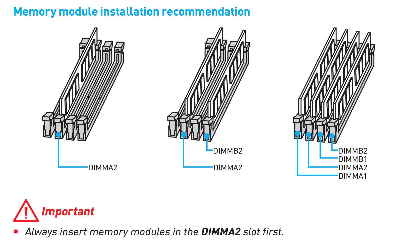

Since you are a newbie, are you plugging your RAM sticks into the recommended slots?
Mar 21, 2023
Yup ram/rams are inserted in dimma 2 slots. I took the ssd out and tried still nothing. Monitor doesn’t even look for an output, when I turn it on it still says no signal.
