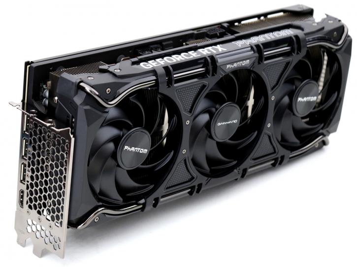

Question Will my existing 850w PSU be sufficient for an RTX 4090 ?
Hello , i currently have a system with i7 13700KF and RTX 3080 10GB but i need to upgrade to an RTX 4090 for a Deep Learning project. The system at this moment has a Corsair HX850 Platinum PSU. Will this PSU be enough to run the system? Nvidia recommends a 850w PSU but aftermarket manufacturers a 1000w one. Nothing in the system is overclocked. I will probably get the Gainward RTX 4090 24gb Phantom because it is the cheapest i can find.
The Guru3D review on that card says 850w should be good enough. And the HX850 is an excellent unit so I'm quite sure it can punch over it's head a bit.
A 1000w ATX 3.0 PCIe 5.0 compliant unit would likely be better, but what you have SHOULD be good enough.
