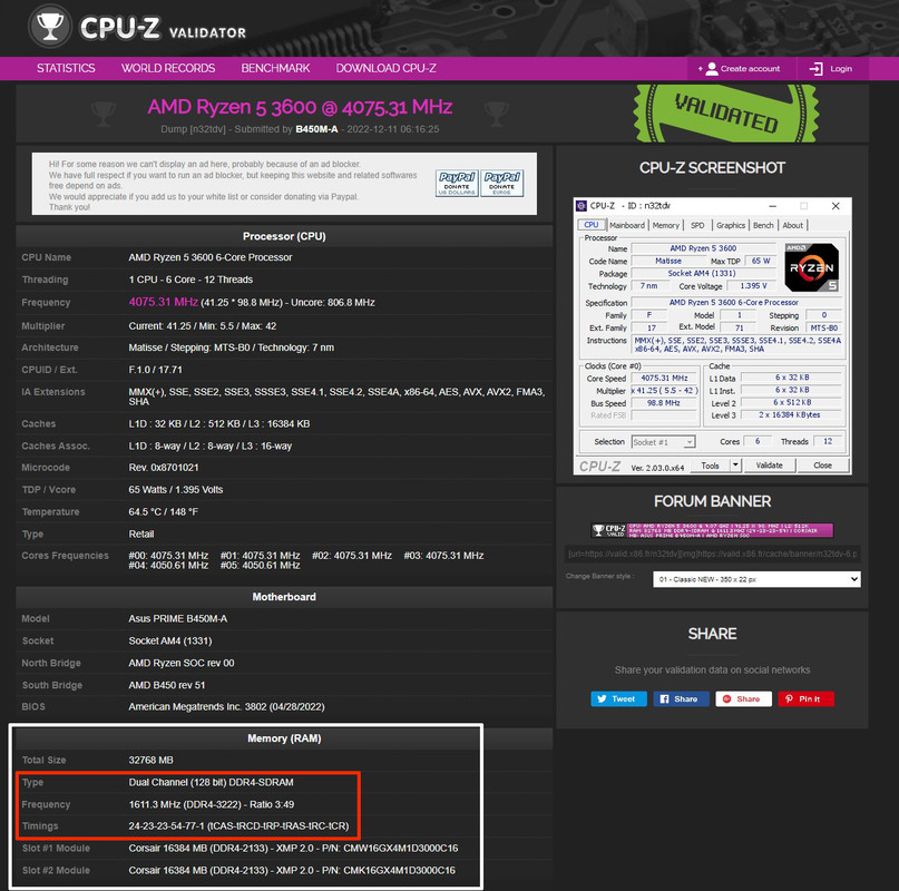

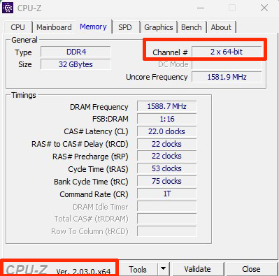

So I finally took my chances and bought a new CMK16GX4M1D3000C16 - VENGEANCE® LPX and paired it with my existing CMW16GX4M1D3000C16 - VENGEANCE® RGB PRO.
Good for me that they are running in dual-channel configuration as far as I can understand.
The latest version of CPU-Z (2.03) is displaying memory channel as 2x64-bit which got me little confused. So I had to check for some answers and found out that all newer versions of CPU-Z since version 2.00 are displaying CHANNEL as 2x64-bit.
I also checked with CPU-Z ver. 1.99 and few more older ones and they are displaying CHANNEL as DUAL.
The VALIDATION of every version (older and newer) I tried resulted in DUAL CHANNEL (128-bit) DDR4-SDRAM.
Posting a few images of my validation results here.
CPU-Z ver. 2.03 Results
CPU-Z ver. 1.99 Results
Just hoping if it could be of help to anyone still looking for answer.

So I switched DOCP (XMP) on in BIOS and tried CPU-Z validation again and got these results now:
CPU-Z 2.03
CPU-Z 1.99
The timings are now 16-20-20-38-70 but still not 16-20-20-38-58.
Should I still tweak the latency manually?
