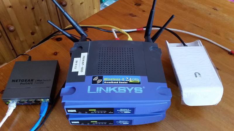

My thought was that if the wireless bridge doesn't work, I could use it for the ham radio mesh network application. I bought a second WRT54G and have $13.50 each in them average. My local ham radio club does emergency communications in concert with the county emergency management agency so something like this would be handy to have:
https://i.postimg.cc/qMPy4xfx/20160609-153002.jpg
