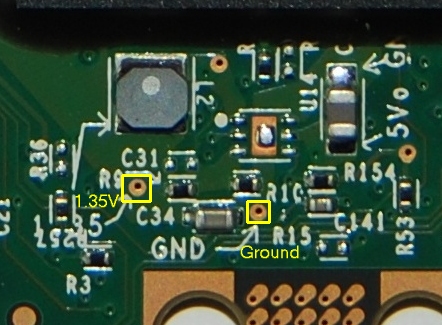

Hi! Could you please help me with my SSD? I plugged 6-pin PCIE to 8-pin CPU, I also plugged 24-pin to 24-pin and 8-pin CPU to 8-pin CPU (my motherboard has two 8-pin CPU power slots) and pressed POWER button, I don't remember what happened next. SSD died after that, undetectable in bios. I see one fried component (A2 P0d) inside. Also it looks like the component have only one contact connected, but I'm not sure, it's so small.
Could you please take a look at the photos and give me any advice? ANYTHING WOULD BE HELPFUL!

The diode can be removed. There is no need to replace it, and certainly no need to cannibalise a donor SSD for this one part.
You need to be mindful of the non-standardised pinouts of modular PSUs. I suspect that this is responsible for the catastrophic damage.
If you have a multimeter, we can do more thorough tests.

Yeah, I'm an idiot. Do you suggest to remove this diode? My concern is it looks like it's already removed from one side.
About multimeter. I think about buying one today or tomorrow.

Yes, it does look like it desoldered itself, which would be bad for the downstream components. Anyway, we'll see what we can find find with a multimeter. Let me know when you're ready.
New info. With diode connected on both sides PC doesn't start (repairman did this for me but I can't work with him anymore). Yeah, I read about that, it means diode is shorted. What should I look for next? I don't have a multimeter yet. Do you think it's okay to buy the cheapest one from some shady brand?
Your "repairman" Is incompetent. It should have taken him only a few seconds to determine whether the diode is shorted. You need to remove this diode. There is no need to replace it, at least not for data recovery purposes. If that's the only problem, then your SSD should work.
That said, we can do more testing when you get your multimeter.

I agree about the repairman, he was too cocky and lazy. I'm looking for another one. As you said before, "Yes, it does look like it desoldered itself" - the SSD didn't work with the diode desoldered from one side, is there any chance that desoldering the diode from both sides will make SSD work? I understand that I need to remove the shorted diode anyway.

It didn't look like the diode was completely desoldered from one side. Wait for your multimeter and we'll take some measurements.
Сould you please tell me what should I measure here, what elements and what for? CR3 (diode) for short circuit - got it. What else. The photos once again:
Your photos are quite poor. You need something better than a potato camera.
Anyway, measure the resistance between ground and each of the test points in the following photo clips. One photo shows 3 inductors -- measure between either terminal of each inductor and ground. You can use any screw hole as your ground reference.
https://i.postimg.cc/hjyZYnXW/Intel-SSD-320-inductors.jpg
https://i.postimg.cc/QNznkXLc/Intel-SSD-320-1-V35.jpg
https://i.postimg.cc/bN2VmK8W/Intel-SSD-320-PCB-TVS-CAW-5-VF.jpg

I appreciate your help. I'll do the measurements of SSD soon.

Your "repairman" is an idiot.
Please remove the shorted 5V TVS diode, ie the one that "beeps both sides". If you don't have flush cutters, then use a fingernail clipper.
He also said that both diodes were good. I asked him about diodes several times. Is that possible that this diode died after a new resistor has been installed?
The 1V8 and 3V3 supply voltages appear to be shorted to ground. If that's correct, then your SSD is not really a DIY case. Sorry. In fact, these are the supplies for the NAND flash, so there is a possibility that one or more flash ICs are dead, in which case even a professional data recovery company will not be able to do anything for you.

Should I remove the shorted diode (CR3) from my SSD and repeat the measurements?
