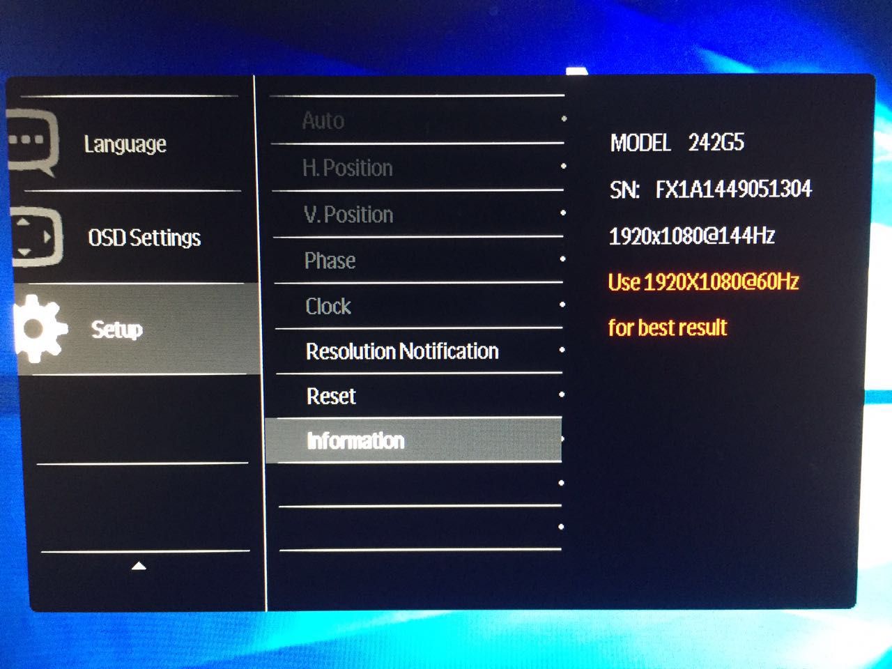

Hello,
Today i got a new monitor (Philips 242G - 144hz). He is not brand new, i changed with someone (gave my Benq RL2455 - 60hz plus some money).

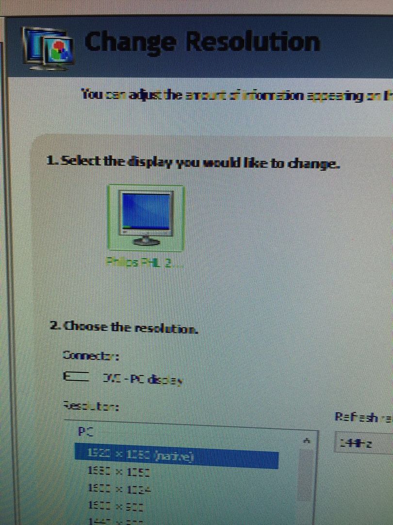

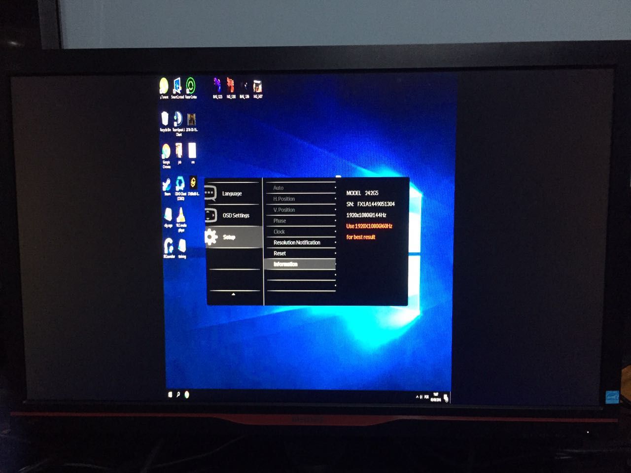

The problem is, when i change my res. to 144hz, the screen is blurry, i cant even read anything, and its normal when i get back to 60hz.
I used to go for 1280x1024 75hz custom resolution in my old benq and i had no problems at all. But when i try to use this same custom res, at 75hz on my new Philips 144hz, i get the same blurry screen, so i dont think the cable is the problem.
Is the monitor broken or anything?

I will post some photos of the display at 144hz (ps: I had to use my phone to take the pictures, cause when i hit print screen the image is normal)
http://i1244.photobucket.com/albums/gg571/eskinamon/WhatsApp%20Image%202016-09-05%20at%2017.16.57_zpsbbfaxu23.jpeg
http://i1244.photobucket.com/albums/gg571/eskinamon/WhatsApp%20Image%202016-09-05%20at%2017.16.58_zps86x1qpb5.jpeg
http://i1244.photobucket.com/albums/gg571/eskinamon/WhatsApp%20Image%202016-09-05%20at%2017.29.51_zps0gejvhfg.jpeg

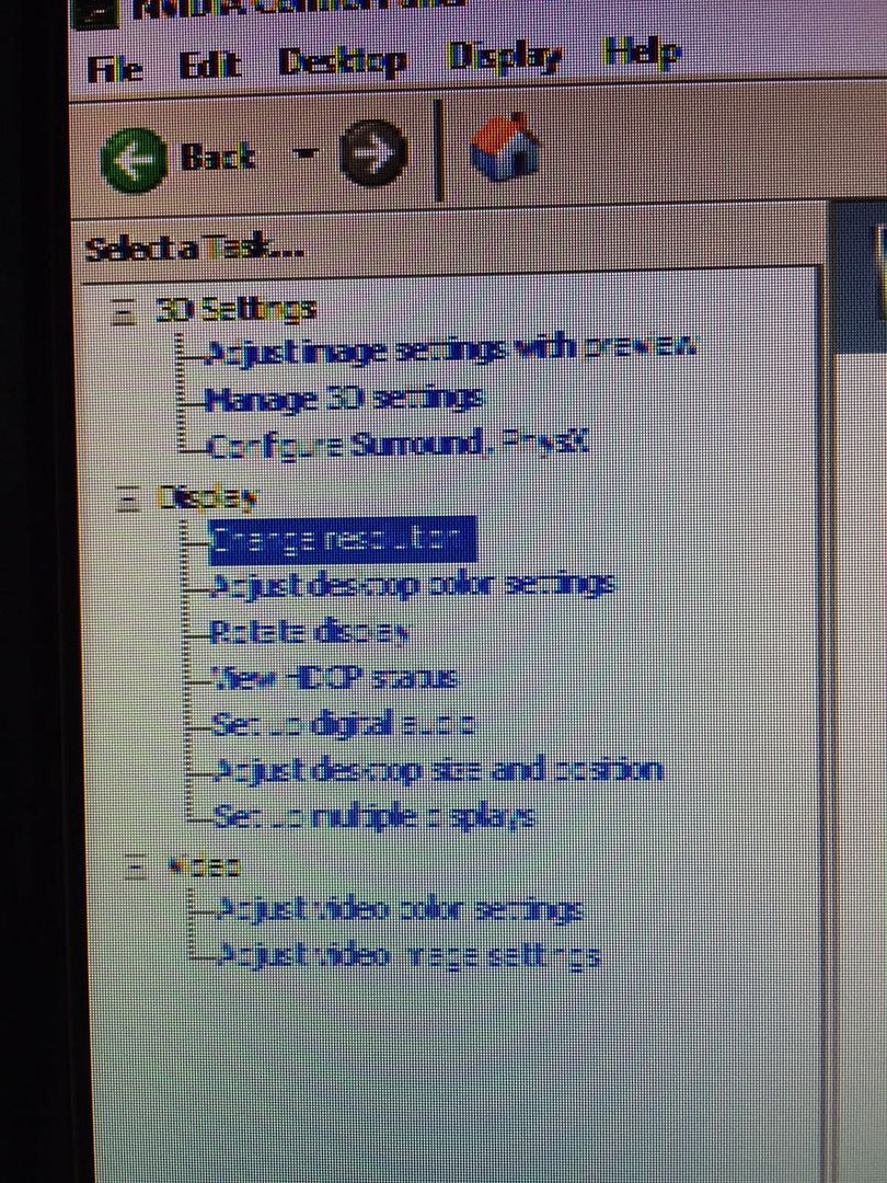

You have Stereoscopic 3D enabled, go into your nvidia control panel and uncheck Stereoscopic 3D, or just press CTRL + T in games, it's a shortcut. I'm not sure if your monitor has 3D vision supported, but try anyways.

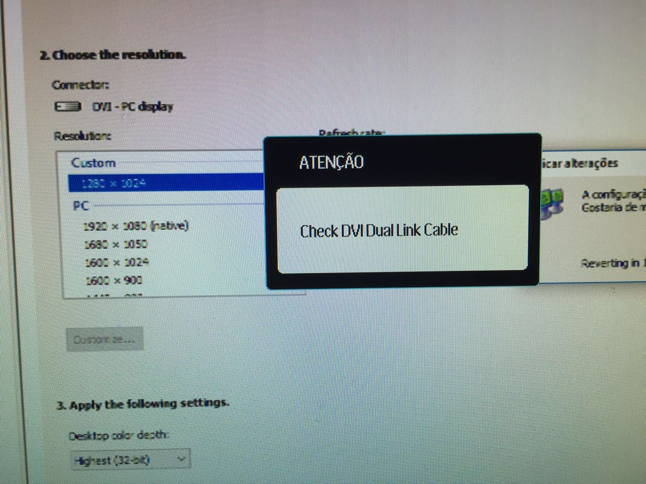

Im using DVI Dual link cable. I dont think its the cable because when i had my old monitor i was running at 75hz easly, no problems at all. But when i try to go for 75hz on this monitor i get this fuzzy screen. On the other hand, when i turn on the 144/120/100hz i get "Attention, check DVI dual link cable"
I will test my monitor in another PC tomorrow
I cant even find this option 🙁
