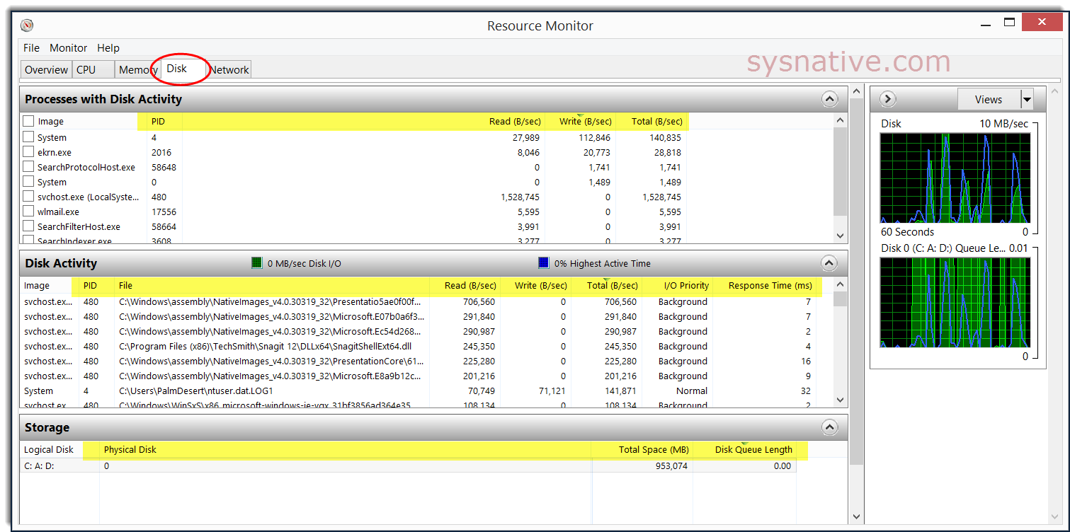

Use Resource Monitor - Disk tab - Disk activity section.
Order it by column Total in descending order.
Make file names fully readable and
show screenshot.
(upload to imgur.com and post link)
You will see offending application and file names, that are being read/written.
Resource Monitor looks like this
