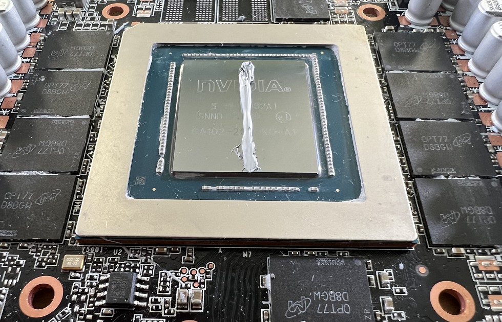

The best article I've seen on thermal paste application:
The effects are the same so I am confident it applies to CPU's as well.
