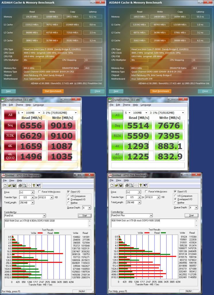

Fully usable OC with ALL C-States Enabled, my CPU runs from 1.2GHz to 4.8GHz, and it sleeps/wakes and performs like 'Stock' but faster - http://valid.canardpc.com/show_oc.php?id=2320509 Some of my SQL compile testing can take 20 minutes to a few hours so a reduction of 20%~50% with a few settings of the BIOS is well worth the efforts. However, if I'm not going to be needing OC then I can simply boot to the BIOS and within 45 seconds be running Stock or OC; BIOS Profiles. None of my OC's has C-States Disabled.
RamDisk 11 'RamDisk Plus' (SQL) - http://i1013.photobucket.com/albums/af254/Jaquith/RamDisk-Testing-X79.jpg
Cinebench (Rendering Video) - http://i1013.photobucket.com/albums/af254/Jaquith/CB-i7-3939K-Stock-v-OC.jpg
