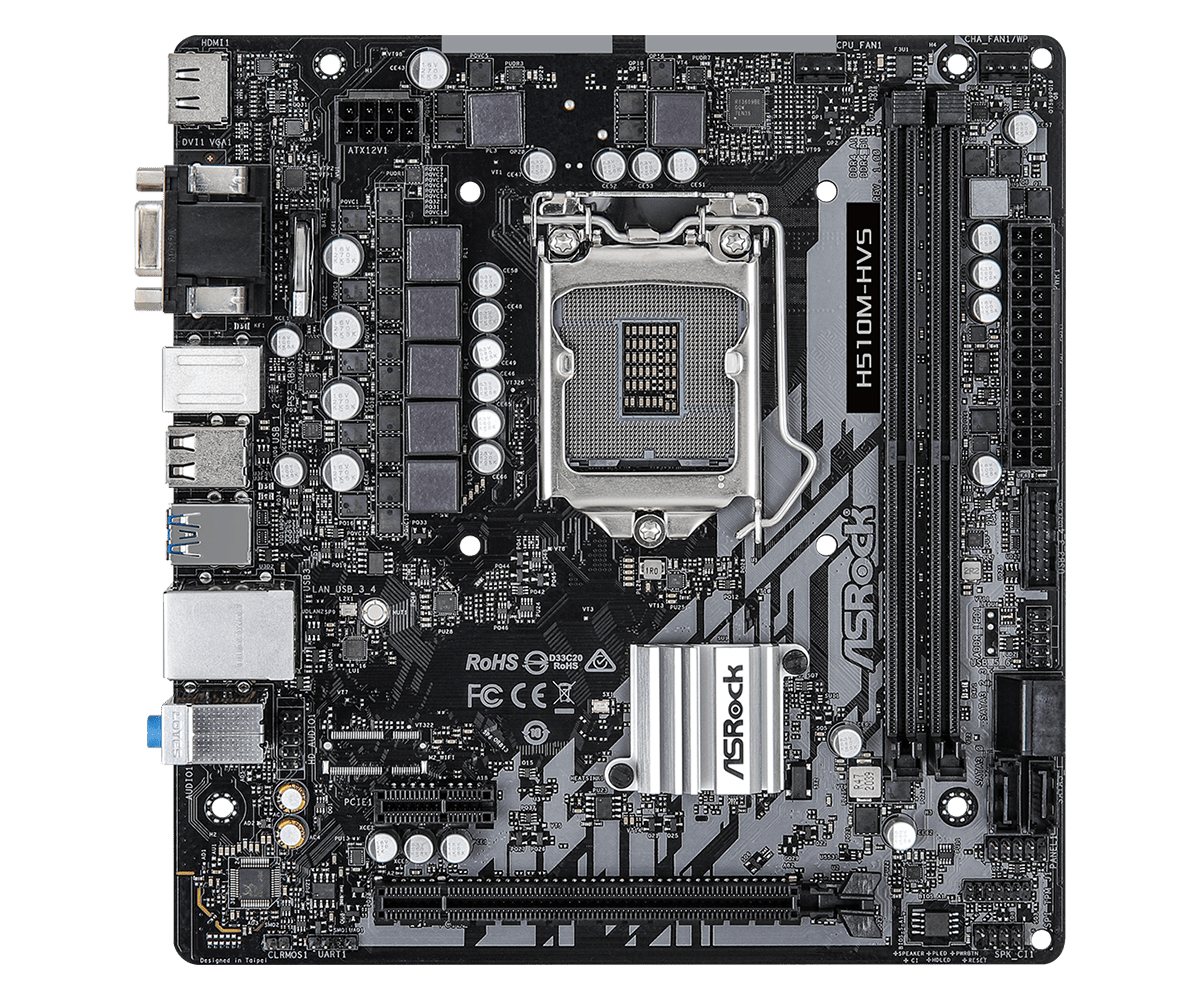

Some MoBos have PCI-E x1 slot as the 1st/upper slot, whereby PCI-E x16 slot is 2nd in line, giving ample room for CPU cooler.
E.g micro-ATX AsRock H510M-HVS;
Specs: https://www.asrock.com/mb/Intel/H510M-HVS/index.asp#Specification
Same chipset (H510), same size (micro-ATX), but different layout.
Thanks for your response: I found this so interesting , as you mentioned the distance between PICE slot and the end of ram slots in my m.b is equal, whereas for the Asrock there is enough space.
