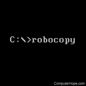

Robocopy is actually your best bet. It will copy across all permissions as well when you use the proper switch/s. It's also already present on systems running Windows 10:
