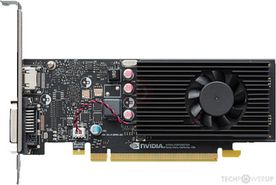

But tbh, idk how would a GTX1070 run on a CPU that old, i was thinking maybe a GTX750 or a GT1030 smth like that, nothing too overkill, just to play at least CS:GO or smth.

now look whats up, the reason i went for the 1030 is cuz it would like match this system pretty well, and it can kinda play some games on 30-40 FPS, plus im gettin a GTX660 in the near future for free and i can just sell that shiz and then sell the GT1030 add some money and buy a better GPU when i have a complete new system but idk.

in conclusion my question is im thinkin about a GT1030 or a GTX700 series card, but idk which would is better.

Don't worry about matching the system--get the fastest thing you can afford since it can move on to another system or be resold at close to the price you'll get it for. If you're getting a 660 for free, just wait for that. Then you can save up and buy something outright. Otherwise, you'll take a hit when you resell the 1030 and the 660 won't be worth enough to cover the gap. Better to use the 660, save up, get a new card, and keep the 660 as a backup.
As far as performance, check these out:
https://www.techpowerup.com/gpu-specs/geforce-gtx-750-ti.c2548
Base performance of a 1030 is faster, but the texture rate (which is used more in games) is higher on the 750ti. When you get something like an OC 750ti, it's faster than the 1030. Also don't rule out the 670 or 770 which will blow both the 750 and 1030 out of the water:
