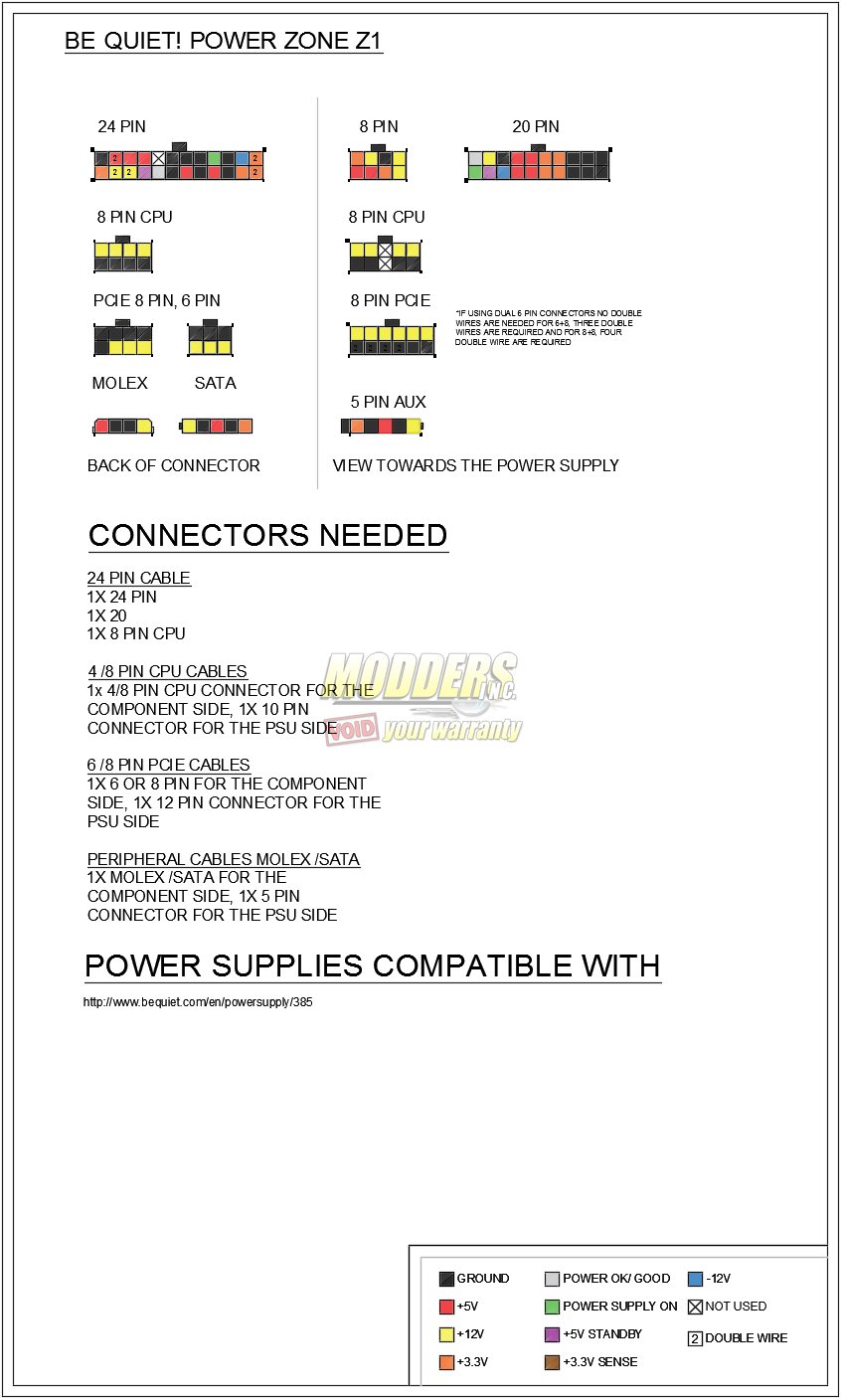

So this is a Dell Optiplex 990 SFF Power Supply. I compared it to my PSU´s pinout and its the same.
And this is a be quiet Power Zone 1´s Pinout. As you can see. its the same. So it should work right?
