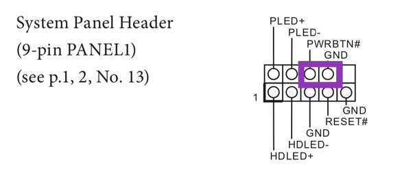

I took my computer from the case and did everything like him on the video, but for now when I connected everything back I dont know if my motherboard has on board power switch on and Im struggling to turn it on. Would be nice if you can say something and if you need I can provide my motherboard: Asrock h61m-vs
These are the 2 pins you need to connect with a screwdriver.
