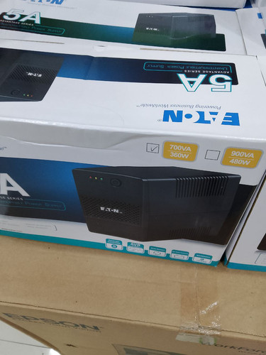

so , no response, ill just go over what i believe i need to make certain that i dont fry this computer, a computer case and the one i posted seems to be acceptable since nobody said no to the one i posted.. ill get that one, it is just a metal frame....
and to replace my UPS,,,, and i dont know if Eaton is a reliable brand but 20-40$cad is ideal for my budget type
nothing else ????
spank you very much, goodbye
At that price, I'd be very surprised indeed if it's true sine wave. Above $150 and you're more likely to find a true sine UPS rated at 750VA, but to be certain, I'd personally be looking at $200+ units. As I've said earlier, true sine is more expensive.
None the less, even if that Eaton 750VA UPS is 'modified sine' or 'sine approximation' which is highly likely, it will still be better than your existing low power UPS. The Eaton will probably work fine with your computer and hopefully give several years of service before you need to replace the battery or the UPS.
But, at such a low price level, it might go bang at any time. It's a risk you take. Known high quality UPS manufacturers such as APC charge 5x to 10x as much for a 750VA unit. You have to ask yourself is it simply blatant profiteering, or are APC units better designed, better constructed and more reliable? If APC units were junk, people wouldn't recommend and buy them.
As for asking a local shop keeper if the Eaton UPS is true sine, they'll tell you whatever you want to hear, unless you've built up a friendship with the guy behind the counter over a number of years, with numerous purchases. They'll be more careful about selling you absolute/dangerous junk, if they think it will jeopardise future business from a good customer. When abroad, I stick to computer shops who know me.
As I said before about the metal frame, it doesn't ground all the components together, i.e. PSU, mobo, hard disks, etc. It's no better from the grounding, protection, RFI/EMC perspective than leaving everything spread out on the table. Get a case and leave the lid off if you will. Much neater and safer for your components.
