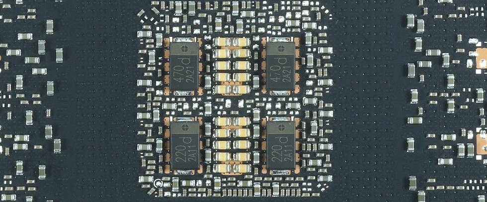

Those are not PoSCaps:
View: https://www.youtube.com/watch?v=GPFKS8jNNh0&t=88s
Buildzoid is amazing. His content is not for everyone, but for those with the willingness, he gives excellent insight into motherboard purchases. He also does the occasional PCB breakdown.
Note also; towards the end of the video, Buildzoid, who was hesitating a touch during the recording, does come out and ask for some oscilloscope readings. As in, sure, they are not PoSCaps, but to know for sure what the problem is, more data is needed.
Also, weird that EVGA called them PoSCaps when they are not? Does not exactly fill me with confidence about their cards...

Many manufacters that decided to cut the number of MLCC capacitors will have to push a firmware update to limit the max frequency and avoid instability.
They may not be Panasonic POSCAPs but they have similar physical dimensions, similar appearance and serve the same function regardless of the specific brand being used.
They are "not POSCAPs" just as much as generic facial tissues aren't kleenexes, most people call them that out of convenience since they are functionally indistinguishable.
does not mean similar Quality though...
Once you get above 100MHz - no tantalum cap is going to be effective - the ESR is too high - the ceramic caps in the center are the best at higher frequencies - I just hope they are a spread of values - .1uF, 0.01uF, 0.001uF, 100pF, 22pF - or something similar - see https://ds.murata.co.jp/simsurfing/mlcc.html?lcid=en-us
and browse for values and display |Z|
The PCB design is just as critical - and the layout allowed both tantalum footprint as well as ceramic devices to be used - that should have been a clue that they hadn't fully characterized the layout.

From what I can tell from the article and jayztwocents explanation on the capacitors, the larger caps are actually the issue (unless you meant the smaller cap clusters are more expensive than the large ones). The smaller MLCC clusters are better at regulating voltage and that's the reason there's more issues with those using the 6 large caps vs the reference using 5 and 1 MLCC cluster (10 mini-caps in each group) and the FE card using a 4/2. From what people are surmising, expect possible firmware updates to keep the cards from going into unstable voltages...
Also, the TUF design uses 6 of the POSCAPS vs the ROG Strix and TUF both are using 6 MLCC clusters. EVGA went 4/2 for FTW and 5/1 for XC3 from what I can tell (which mirrors NVidia's FE design and reference design respectively)
If you mean different values for the same package size, that is largely pointless since MLCCs's useful range is primarily limited by their ESL which is itself a function of package height and length. A single 1uF MLCC would have too much ESL to be of much use to an ASIC with 250-300A draw from CMOS switching, that's why MLCCs get sprayed all over the place. The MLCC arrays in place of polymer caps are likely all the same value in the neighborhood of 1uF assuming they are 0603.

Ooohhhh man Hadien789, read the articale on Igors Lab, Jayz2cents does not even have the TUF card yet, he said so himself in his video.... get the facts right please or it gets very confusing.... Asus only used the MLCCs on it's TUF 3080. Here is the articale with the picture to prove it....
Ooohhhh, read the articale on Igors Lab, Jayz2cents does not even have the TUF card yet, he said so in his video.... get the facts right please or it gets very confusing....
He doesn't, however you can see the layout on the ASUS webpage for both the TUF and the ROG Strix. They show the backplate and the capacitor arrangement.
Edit: I stand corrected, they have the 6 clusters of MLCC, I could've sworn they had the 6 large caps earlier... Might also explain why I couldn't open the images up later as I was shopping around.
A quick google search of TUF 3080 images confirms that I am, indeed, not crazy. There are some images with the black caps and some of them with the updated MLCCs.

What do you have to say about the following though? Steve from Hardware Unboxed has a 3080 TUF Gaming, and it's doing it too.
So no, Asus isn't safe - none of the AIBs are.
