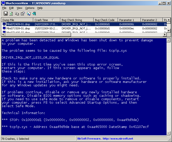

download this application
http://www.nirsoft.net/utils/blue_screen_view.html
you will have some display like this..
under technical information , read stop code..for example :0x100000d1
read the last code, and there it is the explanation..
