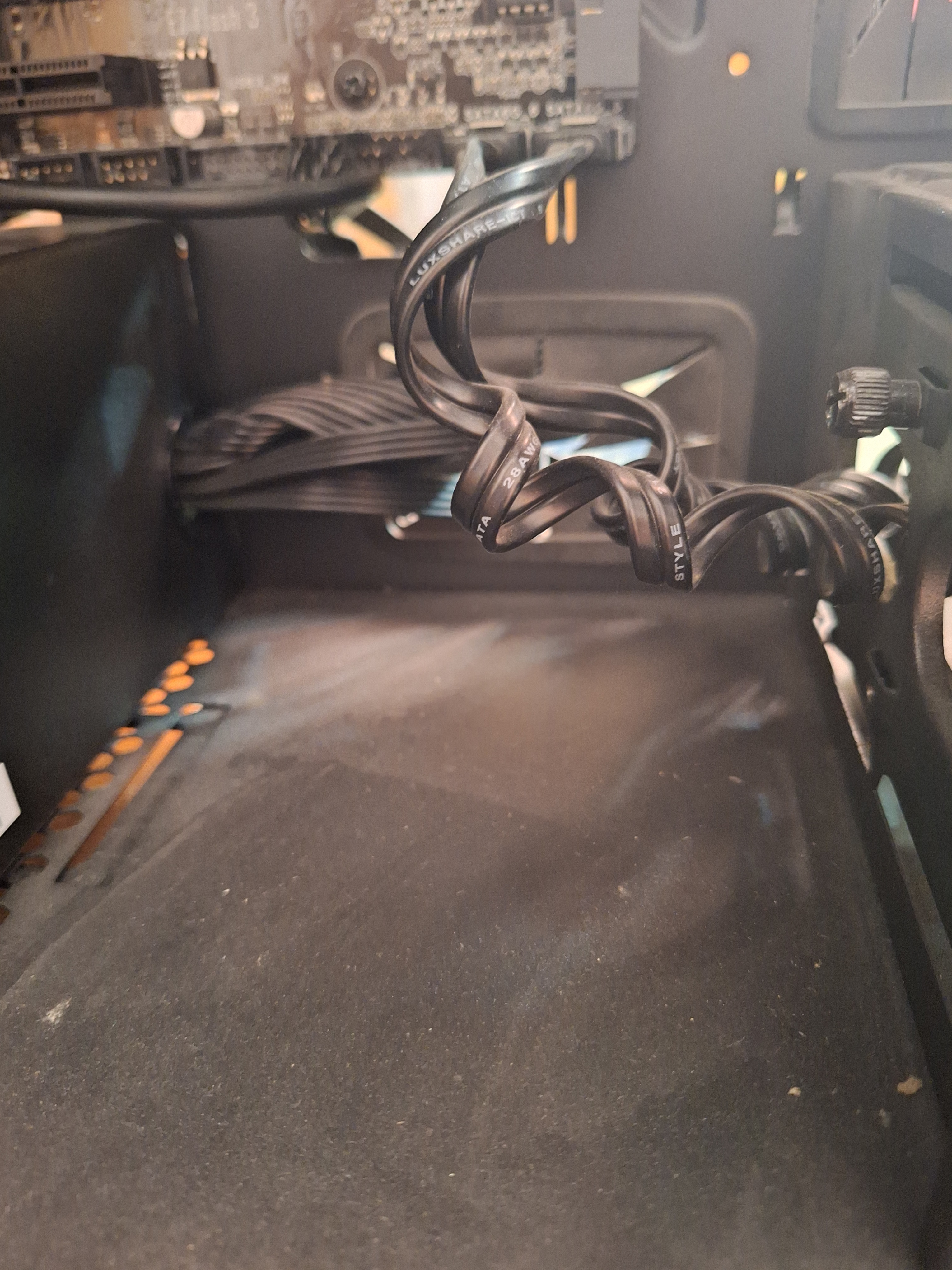

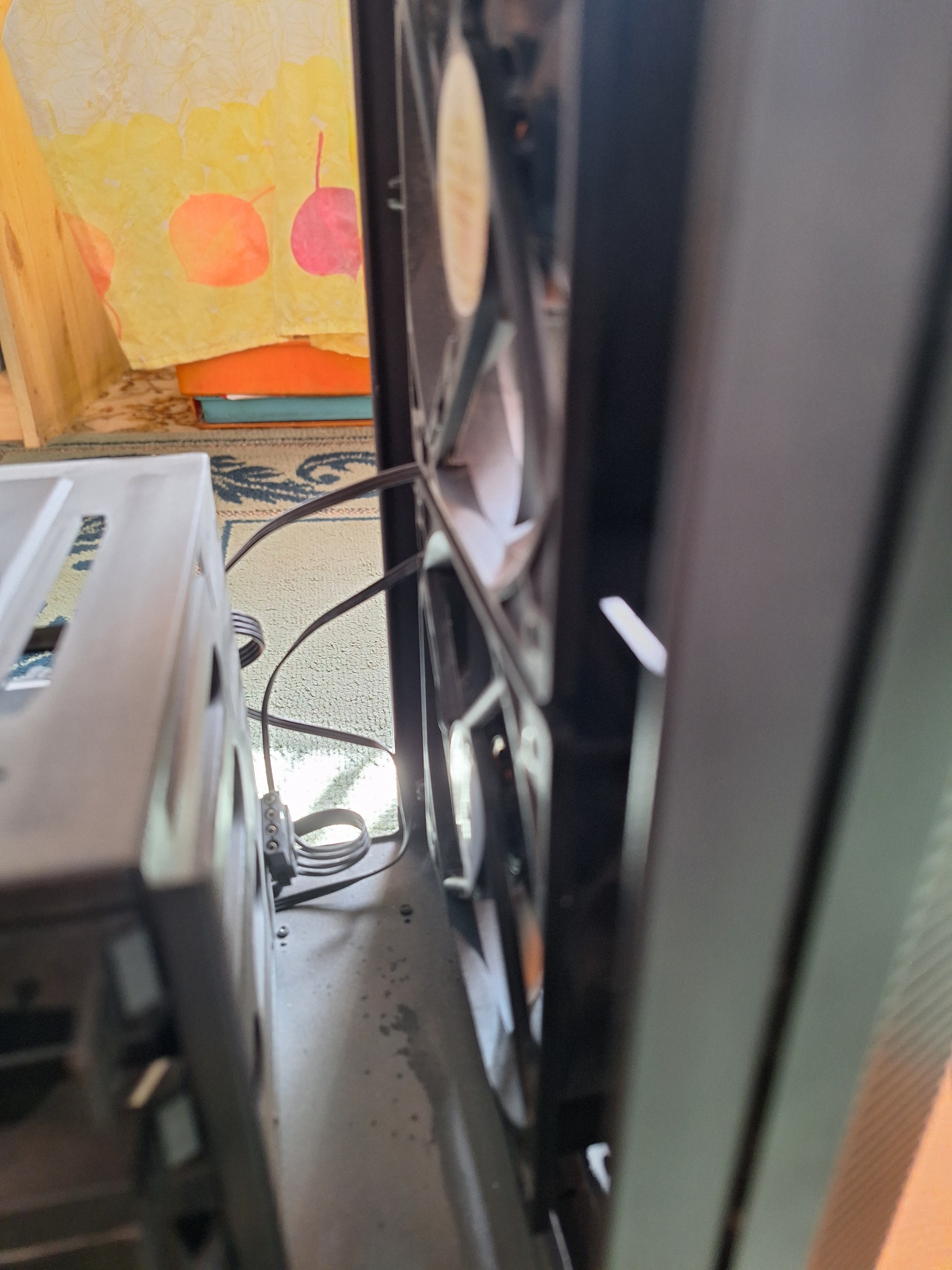

So I took apart my pc and the bottom front fan (that's the loud one even if I spin it with my hand a little is loud) had some parts that came off. I took some pictures.

Maybe these will help, I guess tha fans are conected with the osu under the hdd/ssd drives?
It's still loud and the bottom one spins slower than the rest. And as I said even when I started spinning the fan with my hand it gave out the same sound.
Good photos - well done!
First, it IS possible that the fan has a worn-out bearing and needs to be replaced. The typical symptoms of that are:

However, that may NOT be your case. The photo of parts that fell off shows a fan hub sticky label that fell off, and two small items. At least one of those looks like a stick-on rubber circle used as a noise suppressor that should be between a fan frame point and the sheet metal it is fastened to. Further, one photo appears to show that the bottom fan is farther away from its mounting plate than the one above, as if its fastening is loose. So MAYBE that fan really is simply rattling around just because its mounting screws (inserted from the front) are loose and the rubber pads are missing. Try this. With the case open so you can reach the fans easily and the noise happening, just touch that fan's frame gently and feel whether it is vibrating. Now push it firmly against the mounting plate so it cannot shake, and see if that stops the noise. If it does, try tightening the front mounting screws.
If that does not stop the noise, carefully touch the spinning fan blades to stop the fan completely, then let it go again. If the stopped fan is silent, then you know it IS that fan making noise.
If the fan bearings are worn, you cannot repair. You must replace. See if you can trace the cables from each fan to a common point where they all are connected. A photo of that would help. Also then trace where a cable from that common point goes to - a mobo header, or maybe a PSU output. You'll need this to work on replacement. Let us know what you find.

I took this pic from the front under the hdd
https://ibb.co/Lh869rz
These images are from the back side close to where the fans's cables go
https://ibb.co/d6vk5Rq
I can't really check them closer because these cables are under this hdd cable
https://ibb.co/yXfKnJt
Can I unplug this? And these cables are tied together with something so they don'r tangle up I guess.
In the last two photos you can see pointing directly into the camera an empty female connector with THREE hols and two small ridges along its top edges. THIS is a 3-pin fan connector - that type of connector is ONLY on fans. ALSO, big clue, the cable from it to a fan has THREE wires, unlike many others. You can see the cable and connector clearly on the REAR fan. So, try to follow the three-wire cable from that empty 3-hole connector back toward the fans.
You NAY find this, and at first it can be confusing. But this has been common for older 3-pin fans. SOME of then come with a 3-wore cable that ends in TWO connectors in parallel. One of them is that standard 3-pin female (the open one in the photos). The other on the same fan cable is much wider with FOUR pins, even though only TWO wires will be connected into it. This is the male version of a 4-pin Molex power connector. The female version of it with 4 holes is coming directly from the PSU. You can actually see two of these empty in that last photo on the far right. Such power outputs used to be used as power for things like HDD's and optical drives. But many of those now use a different one called a SATA power output, leaving the Molex ones unused. Anyway, the idea of this fan with two connectors is that you can use it EITHER way. You choose one place (but not both) to plug in the fan - either to a Molex female from the PSU, or to a mobo male fan header. In your case there are NO fans connected to the CHA_FAN1 header at top front, so those three front fans MUST all be connected to PSU output(s). Now, it is ALSO possible that you will find a variation of this. The 4-pin Molex connector on the fan's cable MAY have a female (with holes) on its opposite end so that you can STACK the connectors of several fans and plug them all into ONE female output from the PSU.
You may need to undo that cable tie to free things up and trace the fan cables. But knowing what to look for may help you find them and identify.
