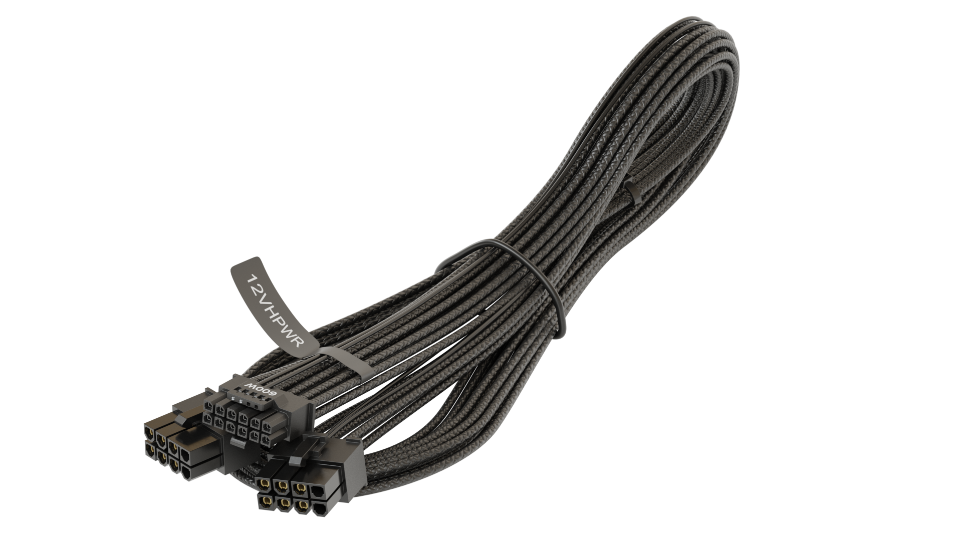

are you running this of the adapter that came in the box
you will need this if you have the crappy adapter supplied in the box people bend them all the time and thats what breaks them.
example below
https://www.scan.co.uk/products/sea...itter-cables-dual-8pin-to-12vhpwr-16awg-750mm
recomendations on not what to do to these cables i assume adapters would be in same camp.
example below
I am running off the cable that came in the box...and I didn't bend the crap out of it, but I'm 100% on picking up a decent jumper direct from SeaSonic. Thanks!
