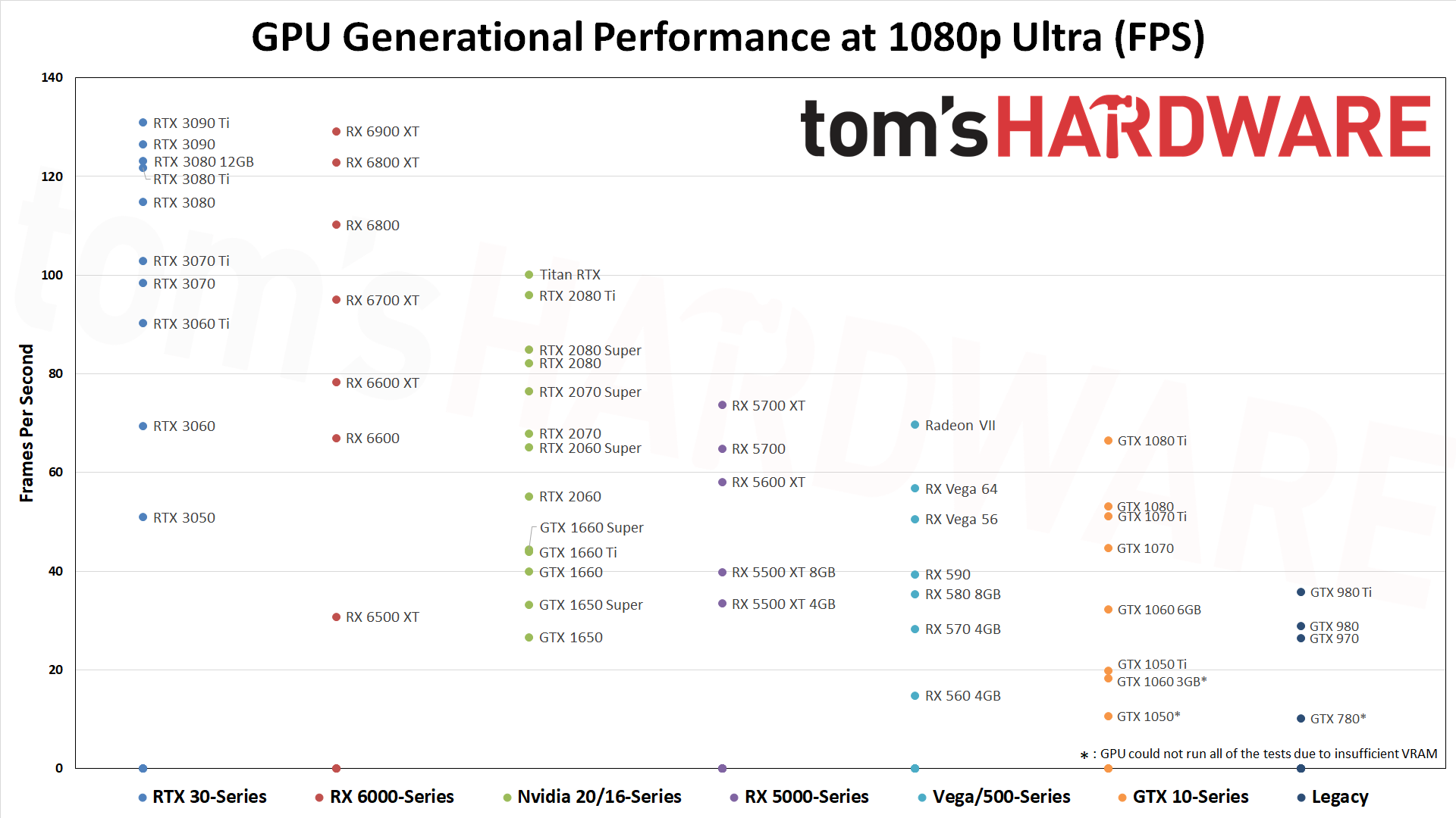

Have you not noticed the image?
So yeah, anything with less than 4GB fails at 1080p ultra on RDR2. And the GTX 780 failed to run Far Cry 6 as well — the game says it needs GTX 900-series, not sure exactly why.
Actually, I've updated the charts to just remove the "could not run" results rather than counting them as a "0" (one), which gives much improved standings that aren't entirely accurate, but whatever. It's as good as I'll get without testing more games and/or using different settings. 🤷
I, uh I did not. But, I was looking in the tables, and didn't notice the graph stuff.
Yeah, it's damned if you do, damned if you don't, with the GPUs that fail in a game.
Though, wait . . now that I think about it... maybe it's not an unfair advantage if you just remove the did-not-run games from the calculation. It probably still, mathematically speaking, correctly reflects the performance capability of the GPU in question, which is what I think we're looking for, but, obviously, the note needs to be there about some games requiring a minimum of 4GB VRAM to run them. But their relative performance positioning looks about right.
As for the GTX 780, it only supports DX12 feature set 11_0, and, from what I understand, FC6 requires DX12 feature set 12. I literally only stumbled across a video about why some older cards are unusable despite still having the GPU horsepower, and the various different feature levels of DX 12, etc., within the past week. It's the only reason it occurred to me to look that up for FC6 and the GTX 780. Fortuitous timing!
Yeah, it's some feature set thing... but it's a pretty odd thing to "require" when the game does support DX11 still. Anyway, lots of games basically look as good as FC6 and still can run on older GPUs, so I feel there's an element of lazy programming to it.
As for the overall score, we're dealing with a geometric mean of eight games, normally. Removing one result (RDR2) won't skew the numbers too much, but unless RDR2 happens to run at exactly the overall average fps, it will cause the scores to go up or down a bit. The GTX 1050 Ti manages to run RDR2 at 1080p ultra and gets 16.8 fps, compared to an overall average (and I mean "geometric mean" when I say "average") of 19.8 fps. So, if I remove the RDR2 result from that game, I get an overall score of 20.3 — a relatively small 2.5% change.
For the GTX 780, it's two games that get removed, but FC6 does tend to run faster than the overall average result, so it probably balances out. Going back to the GTX 1050 Ti, if I drop both FC6 and RDR2, the score changes from 19.8 to 19.1, a 3.5% change. Which means, we're still close enough generally speaking that the tables are "meaningful" even if they're not perfectly apples to apples in all cases.

The rankings are based off of current testing using our updated test suite. So in the games available back in 2020 when the RTX 3090 and RX 6900 XT first launched, the 3090 was faster. With updated drivers and a new suite of games, which card places ahead of the other varies. Across our eight games for the standard test suite, at 1080p ultra, the RTX 3090 got 126.6 fps compared to the RX 6900 XT at 129.7 fps. The RX 6900 XT also wins at 1080p medium, 184.6 fps to 178.1 fps. At 1440p, it's a slight advantage to the 3090: 106.5 fps to 105.5 fps. And at 4K ultra, the 3090 definitely comes out ahead with 68.8 fps to 63.1 fps.
The table is sorted by 1080p ultra as the baseline because 1080p remains the most popular resolution, yes, but more importantly its a resolution where I test (nearly) all of the GPUs — or at least attempt to do so. There's no point in testing about half of the cards at 1440p ultra, and definitely not much use in testing any cards with less than 8GB VRAM at 4K ultra, so I don't. But if you care about those resolutions, you should be able to easily look at the table and determine which card ranks higher.
The same goes for the DXR table with ray tracing. Some people (AMD users especially) want to say ray tracing is stupid and unnecessary, and they can easily ignore that table. But the results are all there in black and white for people to judge for themselves. Factor in DXR performance and the RTX 3090 easily leads even the RX 6950 XT. If you want to try and factor in ray tracing performance, here's an alternative view. This puts even the 3080 Ti and 3080 12GB ahead of the 6900 XT and looks at the geomean of 1080p, 1440p, and 4K non-DXR performance plus the 1080p medium and ultra DXR performance.
