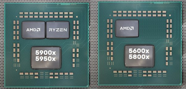

Secondly, Intel use a monolithic die. A single rectangular silicon chiplet dead smack central under the IHS. A pea sized blob is perfect to spread around and cover the entire die easily.
Ryzen like the 3900x use 3 chiplets, 1 on left and 2 on right. This puts the memory controller/Lcache and cores a distance from each other, for heat management, they communicate via Infinity Fabric. As such, the chips are all the way up against the edges and corners under the IHS, so pea sized blob very often doesn't cover everything. This leads to runaway temps and shutdowns. The best way to paste a Ryzen is to credit card or spatula spread the blob beforehand, making sure the entire surface of the IHS is covered in a thin, even layer. This guarantees the cores are covered to the edges and corners.
3900x is same as left picture. Drawing a circle, you'll see how corners get missed easily on the double chip side, which is the cores.
