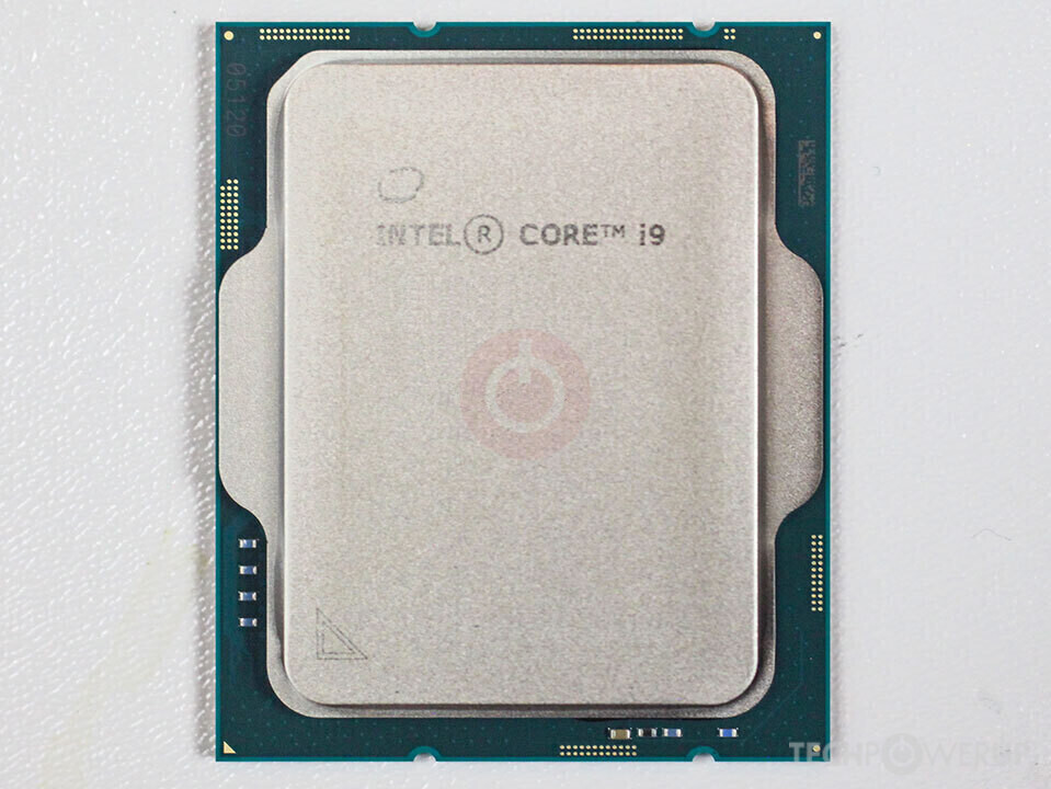

News Intel issues statement about CPU crashes, blames motherboard makers — BIOSes disable thermal and power protection, causing issues
So all of the settings that intel has been OK with, either tacitly or explicitly encouraging motherboard manufacturers to use. Why sell K SKUs and charge a premium for them if they are already at their maximum with intel baseline defaults, and why sell OC chipsets that allow this? Some of these are absurd:
"Using windows ultimate performance mode" <--is that a problem even with intel baseline defaults? Really?
"Disabling C-States" <--is that a problem even with intel baseline defaults? Really?
If those are a problem, then the CPUs can not be run at their baseline spec, its using too much power and generating too much heat, there are workloads that will max them out all the time.
PL1 and 2 have been set equal now, with unlimited tau, is that a problem now too?
Memory overclock it's another nightmare... my asrock motherboard says can overclock the ddr4 at 5000+ mhz Think what voltage at IMC and What gear mode... on my test from 3200mhz to 3600mhz incrase almost 10w from RAM and IMC voltage :) (blazing heat speeds)
Perhaps Intel would have stricter guidelines for respective motherboard manufacturers to follow, given that such issues span for a few months before it could be narrowed down.
So their guidance should have been "When we say our recommended specs we really mean those are our recommended specs and not our "recommended specs", so you should actually follow them?" Do explain Mr. Shaikh how Intel should have been more strict in their guidance.
