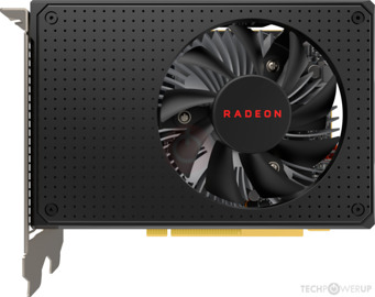

I paired my i3-9100F with RX 550 2GB and its bottlenecking like crazy. Everytime I play Valorant the game framing for couple seconds and it smooth again. Not only does Valorant experience framing, but every game I play experiences framing and fps drops suddenly. Is there any recommendation GPU?
I rather upgrade my GPU first than the CPU.
My build:
Intel Core i3-9100F
RX 550 PowerColor 2GB OC Edition
12GB DDR4 RAM
256GB M.2 NVMe SSD 2nd gen
1TB x 4 HDDs

an RX 550 is just a little stronger than a GT 1030. Certainly not enough if you're gaming hard.
at the bare minimum for gpu upgrade, I recommend an RX 580 if you want AMD, or get a GTX 1650 if you're going with Nvidia. Of course, if you have funds, then go get something better.

i'll consider it on rx 580. thanks for the advice👍
