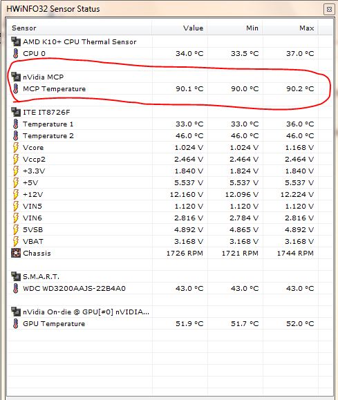

Hiya
I was just checking my PC temperture with HWInfo and it says the MCP is 90C. I then checked this on Nvidia system monitor to confirm it and it said the same thing. I recently bought a geforce gts 250, and installed a 500W PSU.

I took the temperature with different configurations.
Took out the graphics card, and left the case open : MCP = 71C
Closed case/no card/custom side panel fan/pci access panels taken out : MCP = 75C
Graphics card in/ open case : MCP = 79C
closed case/with graphics card/(same fan and panels as above) : MCP = 89C
I am pretty sure it is the thing under the small heatsink now; but also noticed the heatsink is slightly wobbly. Is this a problem, and does it mean that it has come away from the paste a bit?
I would have thought the temp increase with the graphics card installed is expected due to the higher power draw, and reduced air flow around the MCP heatsink.
but 71C at idle, with no graphics and with the case open!?
