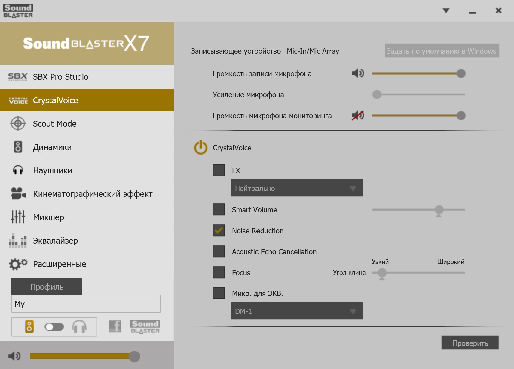

I finally got my mic to work normally with the computer via the Sound Blaster X7. I was very surprised that this was still possible.
In general, it is still inferior in terms of recording quality via a smartphone or through an external professional audio interface, but the result is still very good. In general, the difference is probably even greater in color than in quality itself. Through the X7, the sound is slightly flatter and less rich than when recording through Audient ID4 or a smartphone. Maybe the X7's noise reduction is just rough...
As it turned out, just system settings are not enough - there will be a guaranteed problem with them. But I finally got to the bottom of the necessary settings in the software of my Sound Blaster. There is flexible pre-amplifier control and fairly high-quality noise reduction. And even a whole bunch of special effects (you can even make your own demon voice with real-time overlay), various equalization presets, etc. As it turned out, all this rich features were simply hidden in the “CrystalVoice” submenu, which I perceived as just some kind of unnecessary “enhancer” setting, but in fact they shoved all the settings related to the microphone there. So, it turns out that you can achieve high-quality recording on your computer without a special sound card, although the system settings do not allow this, but it all depends on the degree of development of the audio card software.
