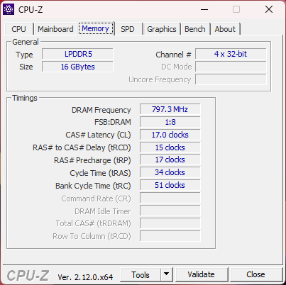

Recently I noticed that my Ram clock speed was capped at 800Mhz, and because I have an igpu, so did my Vram clock speed (which only runs at either 800Mhz or 400mhz and no other values) , even though before it was reaching up to 3000 Mhz.
Laptop: Lenovo IdeaPad 5 2-in-1 14"
_OS : Windows 11
_Specs :
CPU : amd ryzen 7-8845HS
iGPU : amd radeon 780m
Memory : 16GB Lpddr5x 6400Mhz (soldered ram)
Storage : 512GB ssd nvme PCIe gen 4
_The laptop is basically new (I bought in January on the lenovo store)
Here is a list of things that I did before the problem occurred :
_I installed msi afterburner and RTSS (I don't suspect them because I remember seeing the memory clock speed of 2000ish Mhz on the afterburner interface).
_I did an update of amd software.
_Lastly I did a clean up with bitdefender optimiser (after which bizzare looking cardboard boxes appeared on my app icons).
After all those above I noticed on afterburner and cpu-z that my memory clock speed was stuck at 800mhz even in games and stress tests.
Things I tried so far :
_I did a factory reset and a clean download of windows plus a bios reset.
_I reinstalled all the drivers from the official lenovo website.
_I disabled VBS
here is the reading in amd software
and msi afterburner
and cpu-z
i dont think it is dieing i think they have just tied the gpu memory clock to 800.

try gpu z see if you see what the review shows they use this to measure the gpu
are you sure you saw it go to 2300 that could have been the gpu clock not the ram speed.

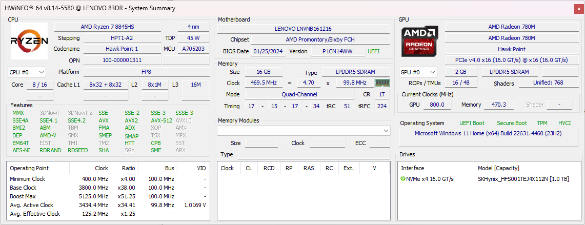

https://www.notebookcheck.net/fileadmin/Notebooks/Lenovo/IdeaPad_5_2-in-1_14AHP9/hwinfo1.png
as you can see in the notebook tech they had 800 as well
I'm sure of it,thegpu clock speed was at 2000 and the memory was slightly higher at 2300.
I'm seing 400 at the clock there

A lot of laptops with soldered memory show 800Mhz DRAM clocks. I saw this a lot when I was checking through Geekbench results some time back. For whatever reason AMD systems with LPDDR/X don't show correct clocks a lot of the time. If you look up other 8845HS systems that use SODIMMs they'll show accurate Mhz/MT. You could verify the memory running correctly by running a test that measures memory bandwidth.
Reactions: beyondlogic
So it's just a reading bug?
I'm pretty sure it is, but it wouldn't be a bad idea to verify you're getting the correct amount of bandwidth from the memory. I'm not sure exactly what it should be since mobile platforms tend to be lower than desktop counterparts so you might have to find a review that runs AIDA64 to verify.
Here's a review showing the same frequency in CPU-Z: https://www.notebookcheck.net/IdeaP...t-is-also-its-fastest.920150.0.html#c12284785
