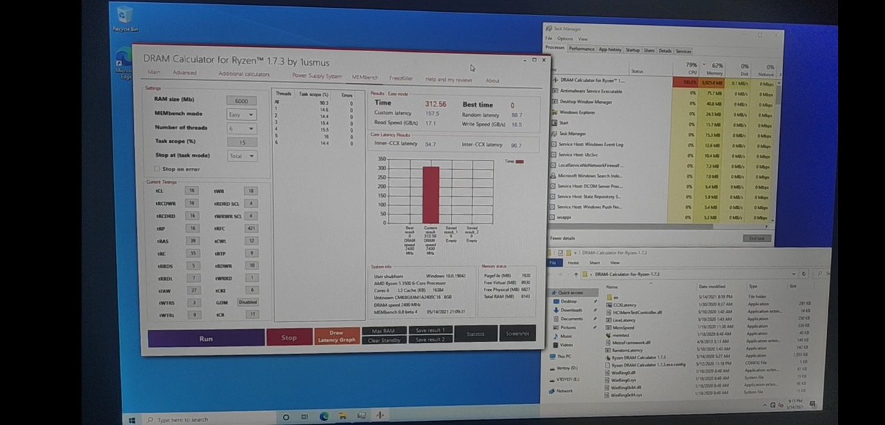

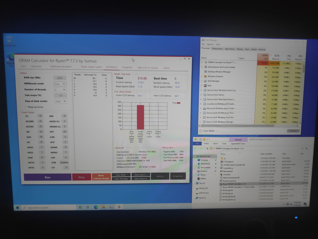

I tried using DRAM Calculator for Ryzen. When i run the MEMbech, windows definitely stays on longer (than without running MEMbench.) But it always shows a red spike at 90.3% Task scope and at that point system restarts or windows is hung.
I ran the MEMbench 4 times (with both sticks tested in both slots one by one.)
https://i.postimg.cc/kGJjFGdZ/IMG-20210515-031722-1.jpg
https://i.postimg.cc/5tJ8FGJK/IMG-20210515-025613.jpg
"other stick i have not tested"
Try it on it's own in the comp, if it boots up Ok, no errors when using the comp, that is a final test.
Same test for the other stick, in other words, only 1 stick at a time.
