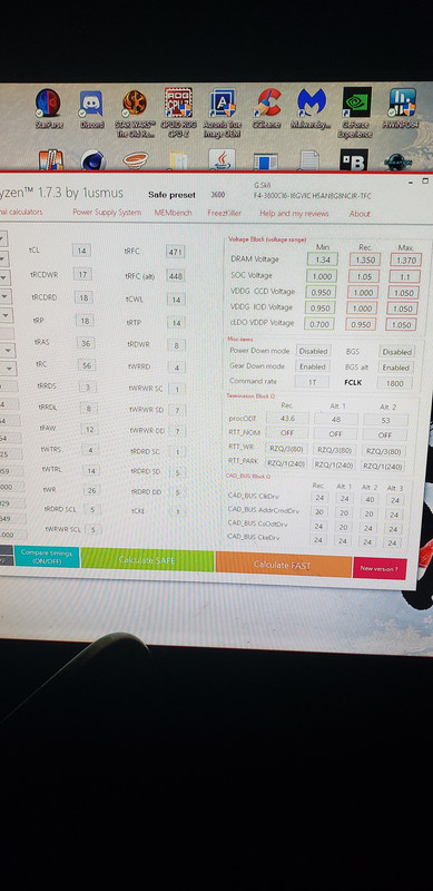

Typhoon burner reads all the essential info from the ram itself. Things like who the OEM is, what chipsets, controller, rank etc. You can export all that info into Dram Calculator in 1 step. So you won't have to actually type in anything.
That'll get you all the timings and subtimings that you'll need. I just took a picture of that screen on my phone, went to my bios and where it says tCL (auto), looked at tCL line on the phone and plugged in that value.
Don't worry about order specifically, most times the order is the same, but different bios will change settings order sometimes. What's important is the name. tCL, tRFC, tRFC (alt) etc will be identical. That's a ram setting, universal, not subject to renaming at all. So while...

Download Typhoon Burner. Use that in conjunction with Dram Calculator (it has an easy import option).
Thatll give you the best timings for your ram. Take a snapshot and just manually plug the timings in according to what title is used. This will include most sub-timings, which are essential for stability.

Yeah i figured and I wasn’t shooting for that anyways I thing I was gonna go with 1800/3800, I was mostly just confused about what order and where you put the timings in because in the Advanced DRAM settings in the MSI Bios the timing labels dont at all seem to go in order and a couple have different titles altogether so I was mostly inquiring about that. When you say easy import option does that mean I can automatically import the timing straight to the BIOS without me having to plug in all the numbers manually?
Don't worry about order specifically, most times the order is the same, but different bios will change settings order sometimes. What's important is the name. tCL, tRFC, tRFC (alt) etc will be identical. That's a ram setting, universal, not subject to renaming at all. So while naming order might be a little floppy, the actual names of the values are good.
This is mine. You'd follow the main settings as in your picture, then open up sub-timings to get the rest. After that, I went to Tools menu and saved the bios to a User Profile. Regardless of any other changes I do/did make to other settings, I always have my ram settings available. I've since made other changes, saved those to other Profiles, but I still have a stock value profile with no changes except for ram timings saved.

Hope it helps you out some. My ram actually didn't like the suggested main timings, luck of the silicon lottery I guess, but was perfectly happy with the subtiming changes. It was enough performance boost to add almost 1000 points to Cinebench R20 by itself. Further manipulatuons by lowering VID voltage got me another 300 points and dropped temps by 20°C which increased boost levels.

I did it but I just used the timings that Thaiphoon Burner pulled for me. I dont think that Ryzen DRAM Calculator works with my 5900X because when I imported the numbers to it it said that the xmp was 3200 which is false and a lot of the numbers didnt make sense unless theres a newer version I’m unaware of. Which in that case I will do more research into locating. But all in all I was able to successfully change the ram to a much better a speed and say significant performance increase thankfully. So I thank you all for the help.
