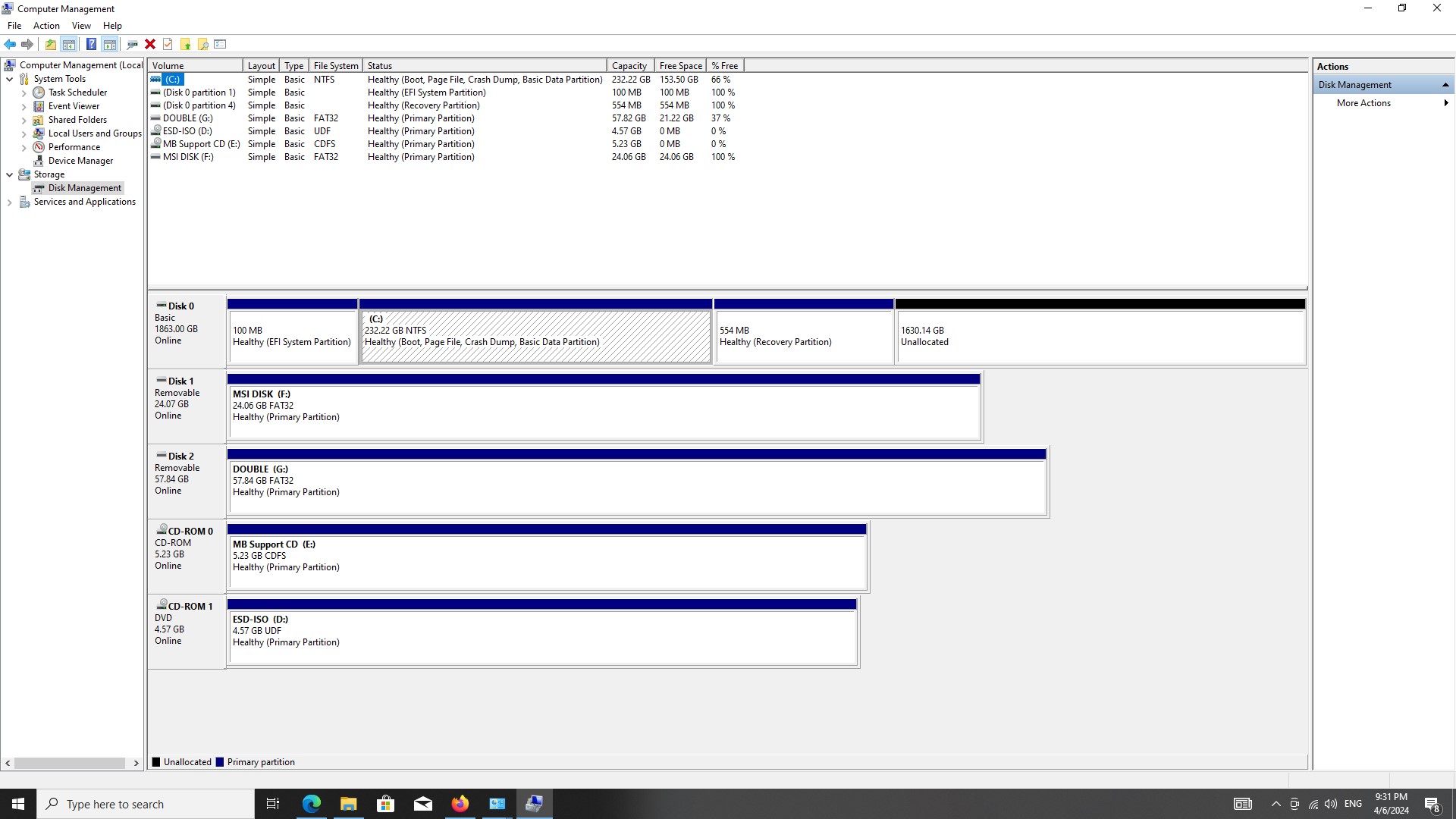

The 2010 PC BIOS shows only one option of Hard Disk perhaps because you only have one HDD(SSD) connected to it?
I dont think so, I have 3 SSDs attached, and it just shows "Hard Disk" and "USB Hard Disk", so if you select "Hard Disk", it just scans the IDE or SATA hard disks in some pre-determined order, and scans the top partitions probably left to right looking for the first bootable one and then uses that.
in any case, I have both XP and Windows 10 from the main drive, and it will always boot from Windows 10, there isnt an option to select the boot partition. to boot from XP, I have to boot to Windows 10, then select "Earlier version of windows":
http://www.directemails.info/tom/XP_win10.jpg

ok, I have 64 bit Windows 10 now installed to the 2T M.2 drive on M2_3, to a partition of 1/8 the size. and am posting this from the new PC! but with the 2007 passive 3D LG monitor, which is a great HD monitor, and USB cable mouse, and PS/2 keyboard via usb to PS/2 splitter.
I have installed Firefox, and imported bookmarks and passwords, eg visiting this forum via the imported bookmark, and logging in using the imported password.

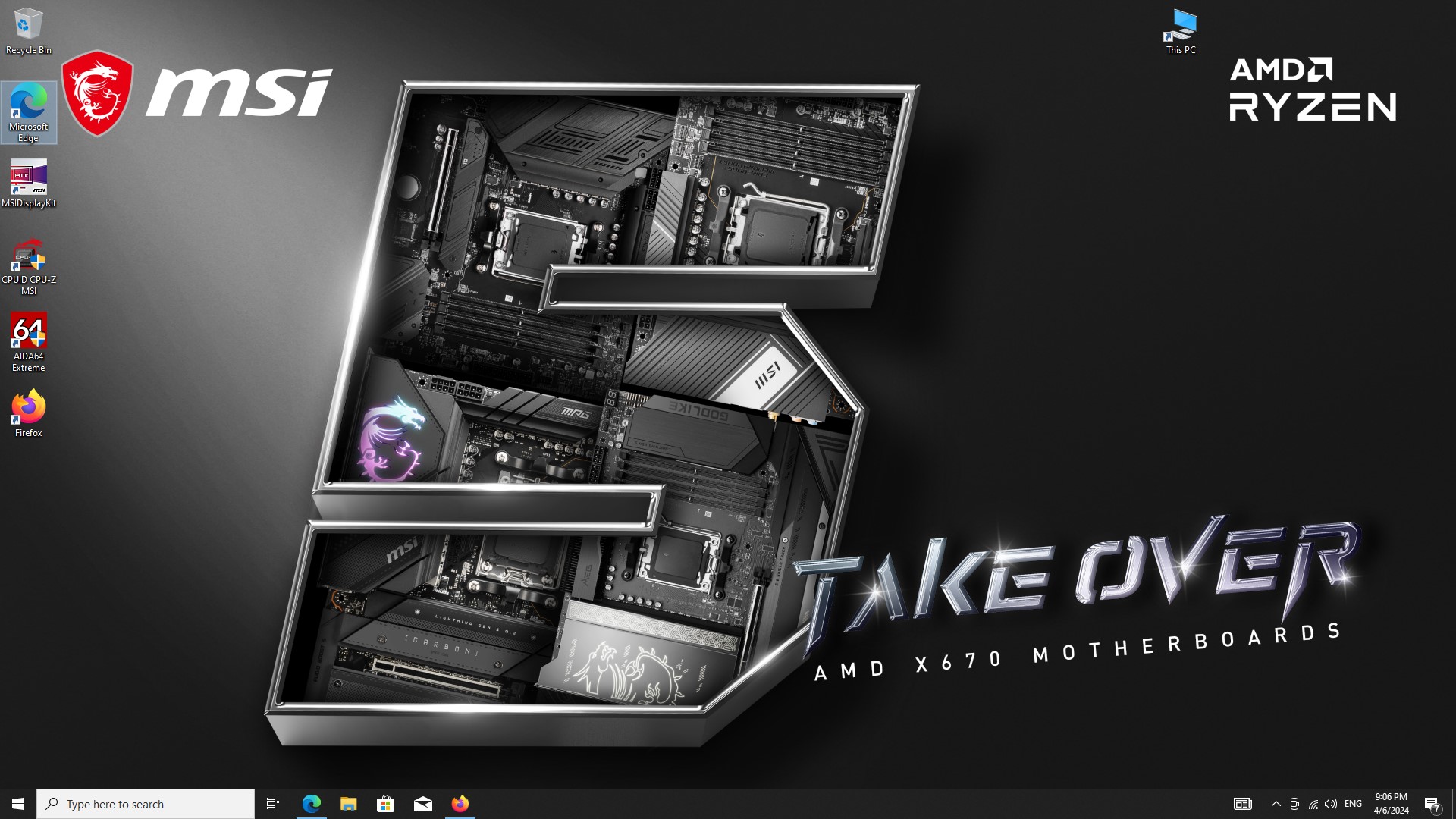

uploaded this screenshot also from the new PC:
http://www.directemails.info/tom/mobo/screenshot.jpg
I am just experimenting at the moment, and am prepared to totally reinstall everything again.
the MSI mobo supplies a flash drive, with drivers, some installs failed, possibly because I tried installing them without rebooting after an initial install which enabled the internet.so will try to reinstall those later.
it was getting really late at night, like after 3am, and I was falling asleep from mental exhaustion, so I didnt want to reboot each time it advised this, but maybe its best to, as that ensures more functionality for the next stage of the install.
the disk setup is like this:
http://www.directemails.info/tom/mobo/disks.jpg
this is just temporary, I might completely reformat and reinstall, I want to see how much storage space is leftover on the system partition, because the MSI mobo seems to have a lot of stuff on it so the current allocation might not be enough.

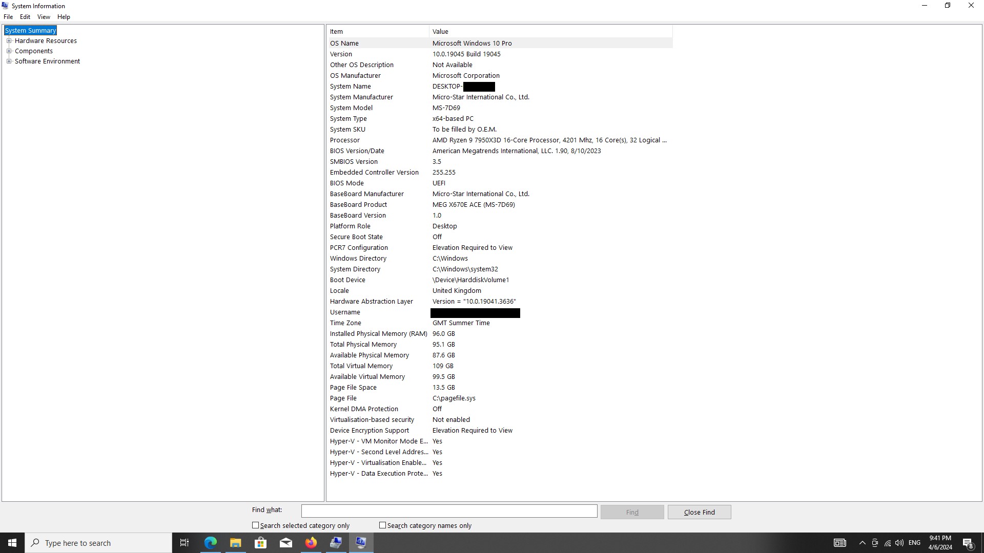

here is a screenshot of the hardware list:
http://www.directemails.info/tom/mobo/hardware.jpg
" to a partition of 1/8 the size"
WHY???
Partitioning a single drive like this is rarely useful.
Currently, you have a 250GB partition for the OS and applications. Unless your system use is very minimal, this will run out sooner than you think.
WHY???
because with my 2010 PC, and 32 bit Windows 10, after a few years of use, the 162GB system disk has some 40G free, 122G in use.
I download and store stuff away from the system drive, the system drive ultimately is just for app installs, projects done with the apps are always to other drives.

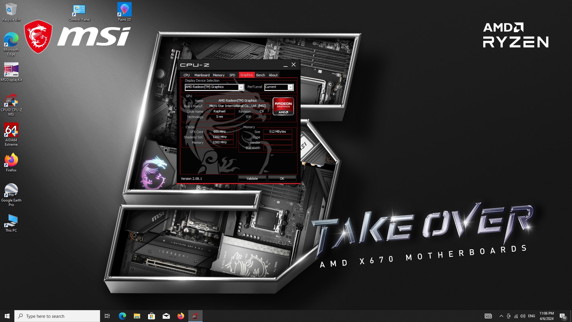

Here is a screenshot showing the inbuilt graphics info, which seems to be ATI Radeon:
http://www.directemails.info/tom/mobo/graphics.jpg
I havent figured out how to do rectangular excerpts from "Paint 3D", I'd have to use my 2010 PC for that, hence the entire screen.
with a program, even 1MB is a lot of stuff, eg a C language compiler can be just 60K. a program instruction is typically 4 bytes, 1MB is thus 250000 instructions! The original AmigaOS fit in 250K, and the original PC all worked within I think 640K.
Well, if it works for you, great.
But things have changed in the last 15 years.
For instance, the VisualStudio Community install can be around 150GB all by itself.
And what happened with Amigas and DOS PCs is totally irrelevant.
Use command of: Alt + Print Screen. This captures only the highlighted window and not entire screen.
Just select the window (e.g CPU-Z), hold down Alt and press Print Screen. Then, when you paste it to Paint, only that program/explorer window is pasted over.

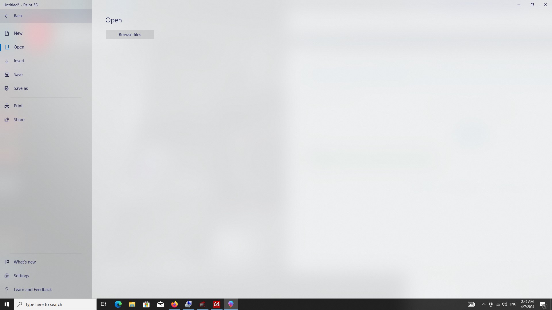

where I asked: I havent figured out how to do rectangular excerpts from "Paint 3D", I'd have to use my 2010 PC for that, hence the entire screen.
you replied:
Snipping Tool.
no idea where to find that, here is a screenshot of the editting of that earlier image:
http://www.directemails.info/tom/mobo/where.jpg
where in that will I find the snipping tool?
eg maybe annotate that
there isnt a normal menu like with apps I am used to. if I click "Menu" in the top left, this is what happens:
http://www.directemails.info/tom/mobo/where2.jpg
