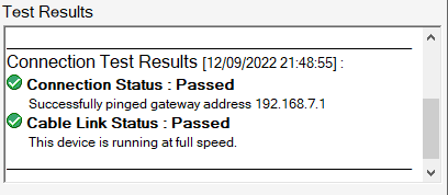

  12. Installed Intel proset drivers to check, I got this error (Already replaced my ethernet with a new one, nothing changed, also change duplex to auto)

Cable Quality Status : Failed
Cable quality is poor or no cable is connected. Possible causes: Faulty cable, faulty connector, or a speed/duplex mismatch. Verify that the speed/duplex setting on the switch/hub is configured for auto-negotiation.
Cable Integrity Status : Failed
The test detected a bad connection. Distance to problem: 225 meters.
I also had this issue with Virgin media but this is a brandnew install of FTTH and the default router Icotera i4850.

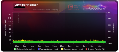

Thinkbroadband monitor

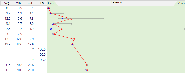

Ping plotter test to check for packet loss

Do you see this issue in anything other than games. If you were to leave a constant ping run to say 8.8.8.8 in a background window does it see any issue that happens at the same time the game detects a issue.
You are correct it can't be 1ms ping but you are trusting a game to give you ping times. Games are known to lie about network times but I have never seen one do this, most blame the huge spikes on the network. What happens is the game get stuck say in a video process and when it finally gets around to looking for its network time packet it blames all the extra time on the network even though the data was sitting there waiting to be read. How it would get 1ms I am not so sure. This is one of those things that I have seen people claim to fix network lag issues by changing video settings. The video does not pass over the internet but if there was a bug I guess this could hide it.

This:
"Replaced all ethernet cables (Tested new cat6 then cat8 no change) both 10m cable. "
And:
"Cable Quality Status : Failed
Where/source did you get the new cables?
Also wondering about that 225 meter distance. Ethernet cables are limited to 100 meters.
Is there an Ethernet cable running from your location to somewhere else? If so, or in any case from what device to what device: Modem to router, router to router, or some other device connection?

Intel Proset is where the error was but that might not be the problem. Like I said above it gave the same error with 2 Isps, new cables and it was still 255m, So I'm not sure if the software is dependable.
I've even disabled my intel ethernet and installed a realtek ethernet card with the same problems ingame. I can't test this with the proset as its not an intel card.
Looking back at the original reported cable problems and then doing some googling, I came across the following link:

  • Set Speed & Duplex to 1Gbps, 100mbps or 10mpbs and check which of them will work for isolation. Recommended setting is Auto Negotiation. Forcing link can result in a speed-duplex mismatch. This is common when one device is set to forced and its link partner is set as Auto-Negotiate.
Check for speed-duplex mismatches.
What device is using the 192.168.7.1 IP address?

And I took a look back and now wondering about the data in Post #3.
The differences in Min, Max, Ave, Last in the last lines for EU1 and EU2. p1 and p2 being Player 1 and Player 2 - correct? However there are differences all along....
Try some "tracert" and "pathping" commands to the listed EUx servers.
Run the commands from both computers via the Command Prompts.
Reference (you can easily find other references):
https://pediaa.com/what-is-the-difference-between-tracert-and-pathping/
Post the results. You should be able to copy and paste with no need to retype the command results.

What caught my attention is that you "MY IP REMOVED" the IP addresses shown for Hop 2 in Traceroute (Post #20).
However, those HOP 2 addresses are shown in PingPlotter Free as HOP 3.
As I understand the tracert(s) in Post # 20 Hop 1 (your router) was originally 192.168.7.1.
Then you added the Asus router.
Per Ping Plotter Free the Asus Router is now your main router (192.168. 50.1) and that is the router that should be providing DHCP IP addresses to network devices. And/or managing any Static IP addresses.
[Note: 192.168.50.1 being a default IP for the Asus router.]
Connections now being (line diagram) with ----> representing an Ethernet cable:
ISP == (Coax, DSL, fiber) ==> Device 192.168.7.1 ----> [WAN Port] Asus GT-AC2900 router [LAN Ports] ----> wired network devices and ~~wireless ~> wireless devices.
Feel free to edit and correct my line diagram as necessary.
So my question is what is that 192.168.7.1 device now being shown as Hop 2? Post #14 shows the device as originally being the Default Gateway. My thought is some modem/router. ISP provided? Make and model? Who has admin rights to that device?
Have all network devices been reconfigured to use the Asus Router (192.168.50.1) as the Default Gateway? Verify that all network devices are correctly configured and using DHCP IP addresses within the the DHCP IP address range allowed to the Asus router. Check subnet masks as well. Ensure that any static IPs are correctly configured and reserved.
The router should provide some listing showing connected network devices, IP addresses, and MAC's. The "arp -a" command via the Command Prompt may help reconcile everything.
If Device 192.168.7.1 is indeed a modem/router has its' DHCP IP functions been disabled?
Also FYI:
Public vs Private IP
I removed the Asus router as I didn't know if it was running double nat. On my old modem from virgin it had modem mode then I'd use the Asus router but on this new modem I'm not sure how this works. I did connect it a small cat6 ethernet cable from the fiber router to the wan port on the asus router then the ethernet to each device. My worry was when I noticed the wifi light was still on the fiber box. So I thought until I get to the bottom of this I'll just run the standard router/modem box from fibercast.
New ping plotter Hop2 is my ip
