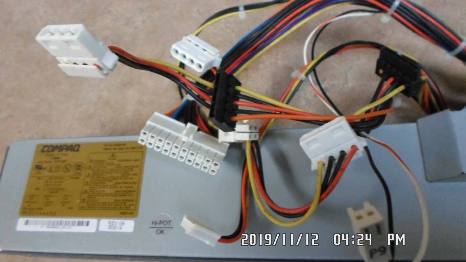

I have attached some pictures below:
Replace the PSU with one that's meant to be in your prebuilt;
https://www.ebay.com/itm/153722639059
and the connector in question is this;
bottom right hand corner, labelled P9, so your PSU is proprietary to the prebuilt, you can't use an off the shelf PSU if you want to be away from that system.
thanks for answering Lutfij!! and where on the motherboard should that be connected? the diagram only shows two 2pin connectors for fans, and they are both occupied in my pc https://www.manualslib.com/manual/359251/Hp-Compaq-D330-Dt.html?page=37&term=board&selected=1#manual
