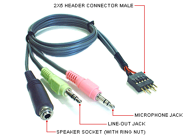

Dang I don't see a front panel header listed in the page linked above that breaks it all down. However I got curious came across a solution that MIGHT work for you depending on your configuration.
Basically with this you could route the rear ports to work on through the front ports.
http://www.frontx.com/store/order_ab.html
