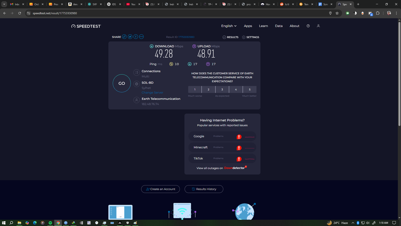

If your internet speed is really only 1mbps then I suspect you will have no issues using a router. Not sure how usable that is, with all the embedded advertising and tracking garbage it will take minutes for web pages to load.

And as suggested, your 1Mbps internet will take forever to load a page in today's world, why do you need Suricata after all? Hackers will not even thinking about attacking a site that's so slow.
how much will it be reduced after the ips/ids, browsing speed for me varies through site to site, for example youtube 1080p without any buffaring
i found openwrt 17 to be the latest and last supported for tplink mr3420.
Suricata has an extremely steep learning curve so will require research. If you can't figure out that 19.07.10 from 2022 was the last officially supported build for 4MB flash devices, or there are later stripped-down 21.02 community builds available that throw everything such as USB support out just to make room for basic functionality, then it's not looking good because in comparison OpenWRT is very well documented.
Needless to say you aren't going to be installing many software packages into 4MB of flash either.
How does money and location affect your ability to notice 100Mb is two orders of magnitude larger than 1Mb? Even a failure in capitalization confusing bits and Bytes would only be one.
its all trial and error for me, i did say im not an expert on openwrt or suricata. i could try adding some adblock filters on that 4mb if possible
where did 100Mb and 1Mb confusion coming from ? i didnt say anything about these, i did say im using 1mb connection and provided a ookla speed test, thats very clarifying isnt it ? also about youtube buffering, these things should clarify any confusion about the internet speed
